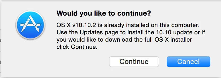

@mhasman Understood. When I try downloading Yosemite from my machine running Yosemite, I receive a dialog indicating it is already installed, but it allows me to click Continue to install. See the attached image.

@stevewood This dialog is deferent on new macs with only "Cancel" option available.
