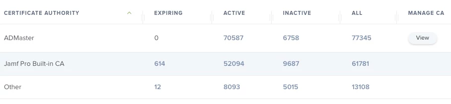

I haven't seen anyone mention it, so I'll ask: Are you using the Jamf AD CS Connector to grab the machine certificate from the AD CS template? Using the AD CS Connector negates the need for the device to be bound; the Connector gets the cert on behalf of the device. We have a setup very similar to yours and it's how we get the certs to both our Macs and iPads.
This Jamf white paper will walk you through the process of setting the connector up.

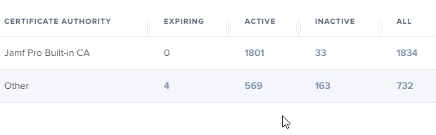

Not sure at all. I inherited this environment. Is there any way to tell if its active inside jamf?
under PKI certificates, i see two connectors but i cant view any properties of them... so not sure.
however i was able to solve the problem by reimaging the device. It can now get keys fine. i spent some hours looking for another way and then just gave up and reinstalled osx.
Sorry that I'm just now getting back to you!
It should be listed in the exact area of your screenshot, so it looks like it's not installed. I can't back this up with anything, but I think that a stock install of Jamf Pro will have the built-in CA and 'Other'. We have a 3rd CA, which is our AD Certificate Authority connected via the AD CS Connector.
