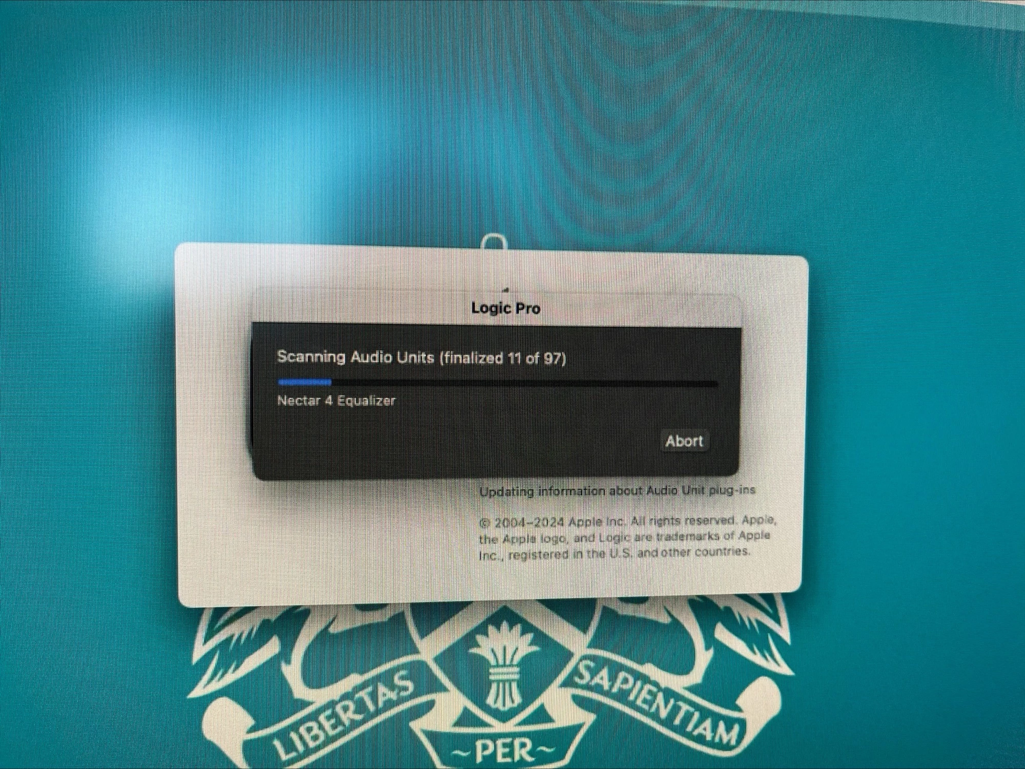

So created snapshot based on this index idea https://yearofthegeek.net/posts/install-logic-pro-with-all-audio-indexed-using-casper-suite/.
It does only index once with the dmg installed, if you login again with the same user account opens without indexing. So unsure what the expected behaviour should be.

while this does seem still trigger indexing of the loops on startup of logic it does seem faster from the testing I have done for new and exisiting users. Does appear to be something that just has to happen. Thanks for your help and suggestions.

Im using your dmg and still getting a prompt to index loops. I compared both dmg in composer and they appear to be the same.
Could it be a permissons issue set root and wheel in my dmg 755.
Have also selected Fill user template option.
Currently using Logic Pro 11.1.1
