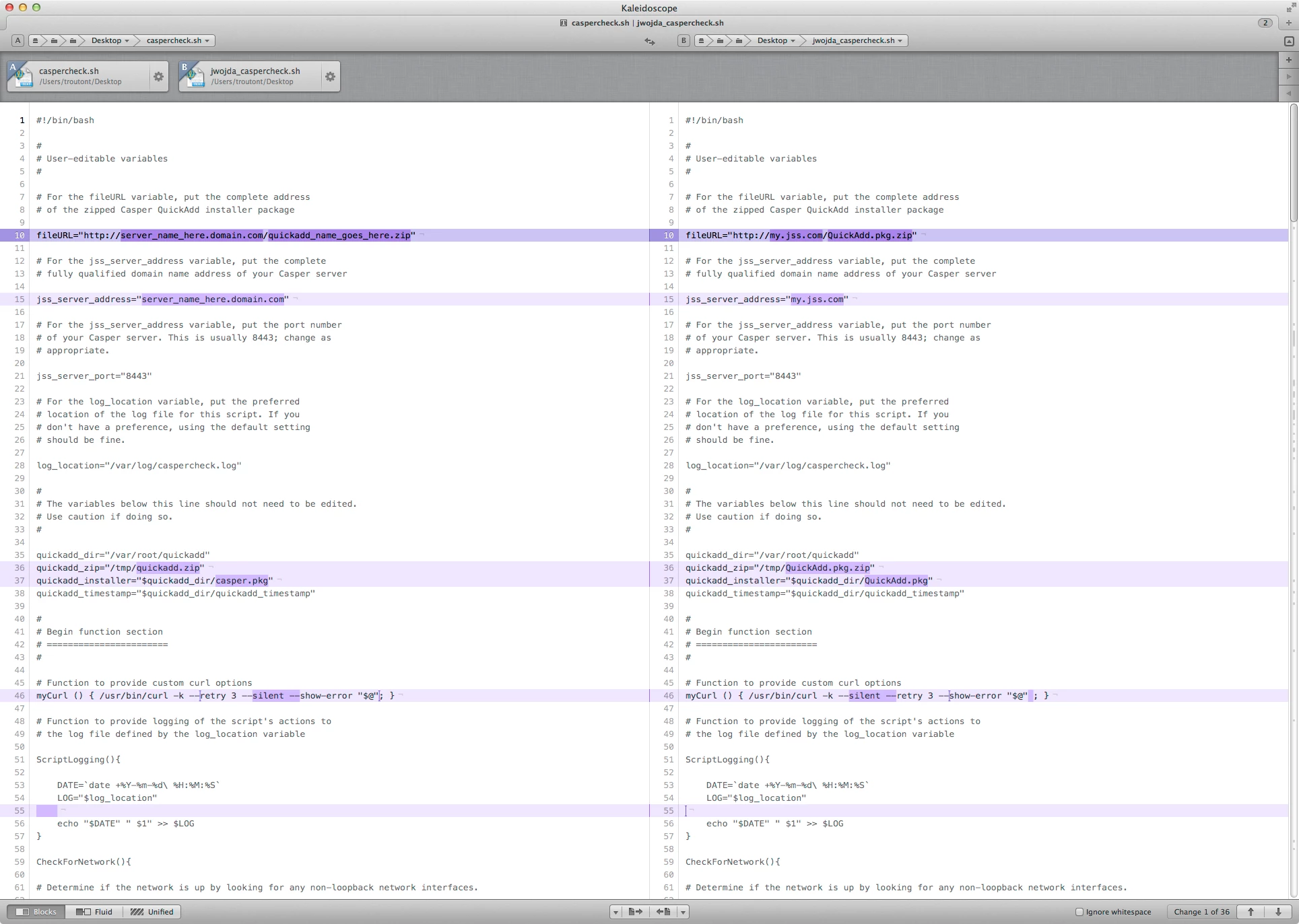

then in /Library/Scripts/CasperCheck.sh
# User-editable variables
# For the fileURL variable, put the complete address
# of the zipped Casper QuickAdd installer package
fileURL="http://my.jss.com/QuickAdd.pkg.zip"
# For the jss_server_address variable, put the complete
# fully qualified domain name address of your Casper server
jss_server_address="my.jss.com"
# For the jss_server_address variable, put the port number
# of your Casper server. This is usually 8443; change as
# appropriate.
jss_server_port="8443"
# For the log_location variable, put the preferred
# location of the log file for this script. If you
# don't have a preference, using the default setting
# should be fine.
log_location="/var/log/caspercheck.log"
# The variables below this line should not need to be edited.
# Use caution if doing so.
quickadd_dir="/var/root/quickadd"
quickadd_zip="/tmp/QuickAdd.pkg.zip"
quickadd_installer="$quickadd_dir/QuickAdd.pkg"
quickadd_timestamp="$quickadd_dir/quickadd_timestamp"
# Begin function section
# Function to provide custom curl options
myCurl () { /usr/bin/curl -k --silent --retry 3 --show-error "$@" ; }

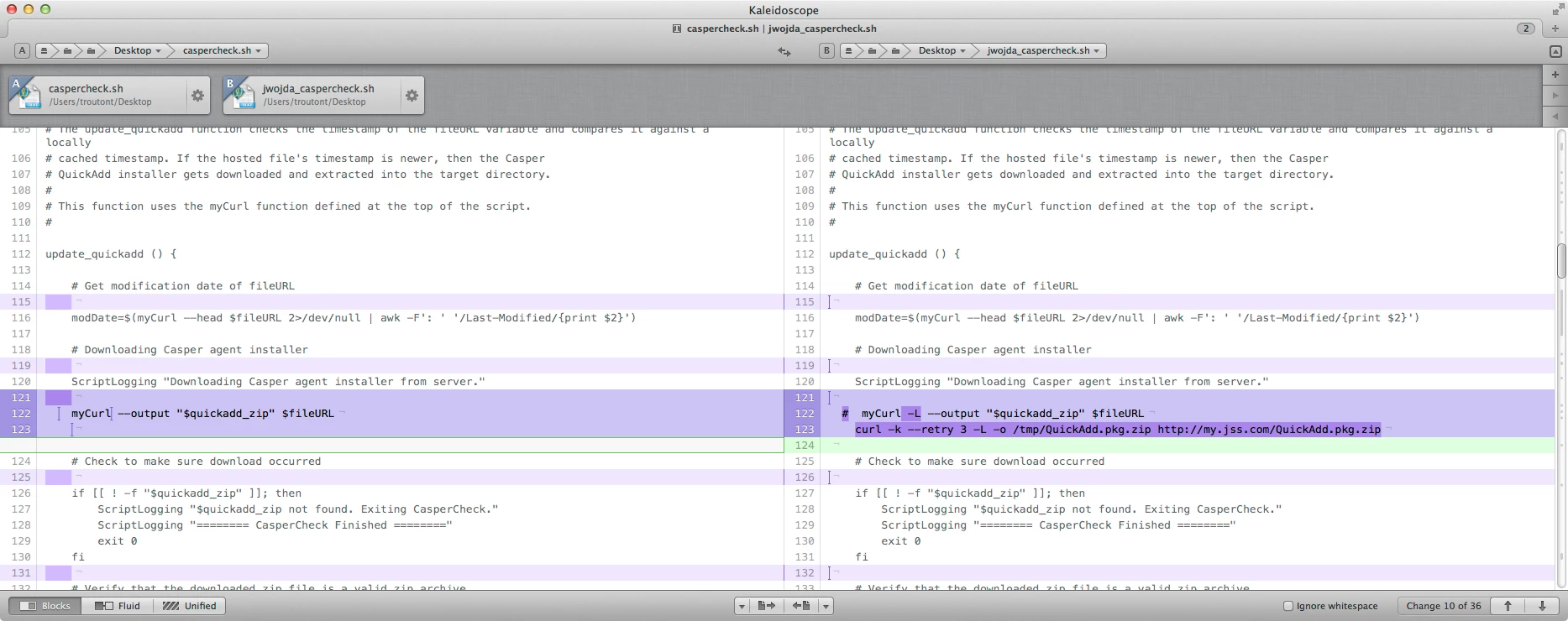

update_quickadd () {
# Get modification date of fileURL
modDate=$(myCurl --head $fileURL 2>/dev/null | awk -F': ' '/Last-Modified/{print $2}')
# Downloading Casper agent installer
ScriptLogging "Downloading Casper agent installer from server."
# myCurl -L --output "$quickadd_zip" $fileURL
curl -k --retry 3 -L -o /tmp/QuickAdd.pkg.zip http://my.jss.com/QuickAdd.pkg.zip

OK, after diffing your script against a stock copy of CasperCheck, I can point out a few places where you may be having issues:
The variables in this section have been edited and that's likely where your problems began.:
From:
quickadd_zip="/tmp/quickadd.zip"
quickadd_installer="$quickadd_dir/casper.pkg"
To:
It also appears the myCurl function in the script has also been edited. CasperCheck uses this function to download the QuickAdd package from the address referenced in the fileURL variable.
It also looks like the myCurl function in the script has also stopped being used to download the QuickAdd (possibly because the edits to the myCurl function made it no longer work properly.) Instead the update_quickadd function has been edited to call curl without using the myCurl function.
However, because the directory path to curl is not being provided as part of the edits, the script is now implicitly relying on a PATH environment variable being available in order to find curl. That PATH environment variable is available when run manually using a logged-in user's account, so curl can be located when the script is run that way, but it isn't there when the script is run via the LaunchDaemon, so curl can't be found.
It may be worth starting over with a fresh copy of CasperCheck and not edit anything in the section marked below, or in any of the functions:

OK, when reset back to the original script's parameters, it looks like you have an issue curl'ing down the zipped QuickAdd to your machine. When run via the LaunchDaemon, it looks like curl is not downloading the file and not leaving anything in /tmp. That's triggering this warning and script exit:
https://github.com/rtrouton/CasperCheck/blob/master/script/caspercheck.sh#L124-L130
When run while logged in, it appears that curl is downloading something to /tmp but it's not a valid zip file. That's triggering this warning and script exit:
https://github.com/rtrouton/CasperCheck/blob/master/script/caspercheck.sh#L132-L143
Long story short, you've got a curl issue downloading from the webserver the QuickAdd is hosted on.
