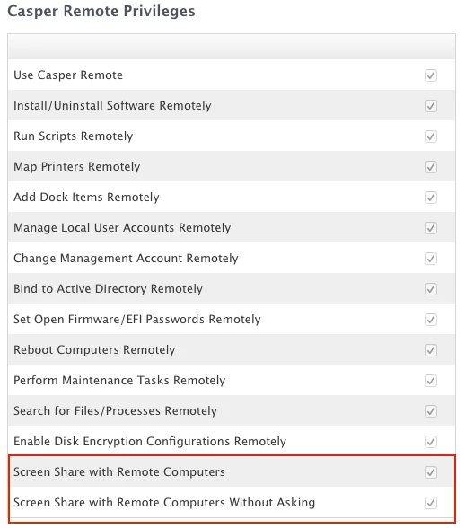

It sounds like you might need to disable screen sharing in Casper remote and have them use something else. That being said, have you tried changing some of the privileges:

@CasperSally have you tried turning off the without asking option? if it has to prompt the user I am fairly certain they will not get the other option. if I get time to play around today I will try to test that as well.
@nessts - we never have allowed the without asking option for the techs, part of our policy requires the request for control/view.

FWIW, that Screen Share with Remote Users Without Asking checkbox is a no-no in every environment I've ever been in (legal, HR, and security mandates).
So we have to make sure hat box is off for all JSS user/group accounts.
So we have only the Use Casper Remote and Screen Share with Remote Users enabled for techs.
