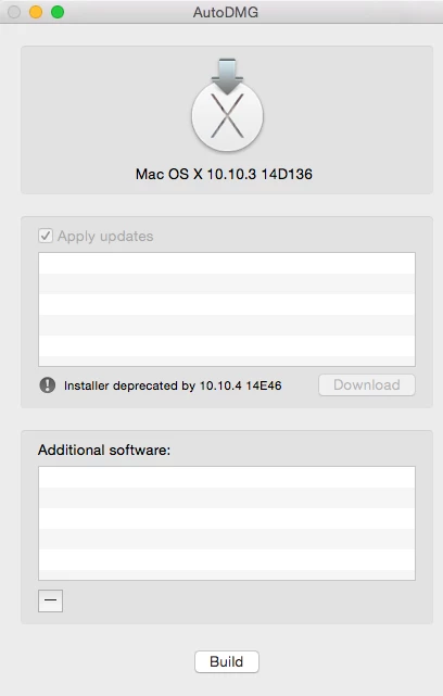

Hi All,
I just updated that plist file, and re-opened autodmg. My only questions is, for 10.10.4, what am I dragging into the OS area? All the App Store seems to let me download is the 10.10.3 14D136 installer, and I still get the message "installer deprecated by 10.10.4 14E46. Any help would be greatly appreciated.
Are you on 10.10.4 yet on the box you're using to build the AutoDMG installer? I believe the host OS and AutoDmg'd OS need to match.
I believe it is only AutoCasperNBI you can have a mismatched OS, right @bentoms ? AutoDMG needs to match like @emilykausalik said.
I got that error, I just re-downloaded the Install Yosemite app from the App Store and then it worked.
@ssrussell Correct! AutoCasperNBI does not need the same OS.
https://macmule.com/projects/autocaspernbi/#OSdmg
