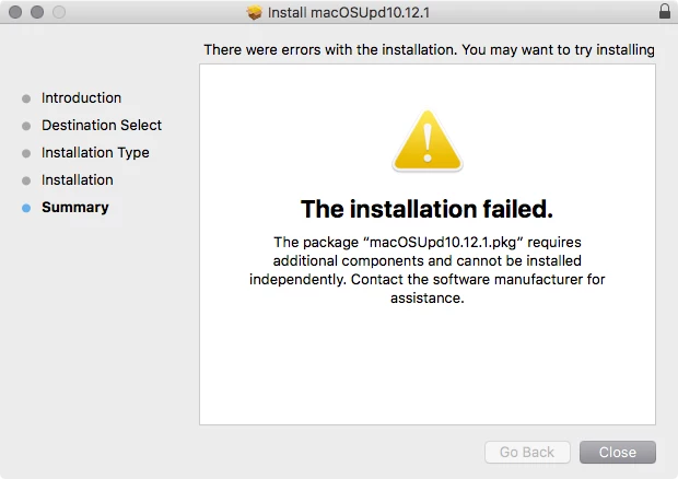

@TomH Sorry, but macOSUpd10.12.1.pkg is not working

@mhasman I would say best bet is to pre stage those files into the correct location and then let the App Store go for it, thats if its not caught by a caching server?
If we wanted to try and create a package I would suspect that we would need to build the entire update including all the packages above etc with something like:
productbuild --distribution ~/Downloads/031-86699/031-86699.English.dist --package-path ~/Downloads/031-86699/ /tmp/macOSUpd10.12.1Complete.pkg
This should then spit out a standard PKG to run...
Regarding the FirmwareUpdate.pkg could this be a fix for Apple SMC ?
We could try something like:
localDir="/tmp/031-86699"
pkgName="macOSUpd10.12.1Complete.pkg"
function downloadFile
    fileURL=$1
    fileName=${fileURL##*/}  # retain the part after the last slash
    if [ ! -d $localDir ]
    then
        mkdir $localDir
    if [ ! -f $localDir/$fileName ]
    then
        echo "Downloading $fileName"
        curl -o $localDir/$fileName $1
    else
        echo "File $fileName exists skipping"
function buildProduct
    distXML="$(find $localDir -name '*.dist')"
    productbuild --distribution $distXML --package-path $localDir /tmp/$pkgName
    echo "Package avaliable at /tmp/$pkgName"
    open /tmp/
downloadFile http://swcdn.apple.com/content/downloads/00/27/031-86699/volvzezccz6wt97sc8zi3z55d7cinlnte3/macOSUpd10.12.1.pkg
downloadFile http://swcdn.apple.com/content/downloads/00/27/031-86699/volvzezccz6wt97sc8zi3z55d7cinlnte3/macOSUpd10.12.1Patch.pkg
downloadFile http://swcdn.apple.com/content/downloads/00/27/031-86699/volvzezccz6wt97sc8zi3z55d7cinlnte3/macOSUpd10.12.1.smd
downloadFile http://swcdn.apple.com/content/downloads/00/27/031-86699/volvzezccz6wt97sc8zi3z55d7cinlnte3/FirmwareUpdate.pkg
downloadFile http://swcdn.apple.com/content/downloads/00/27/031-86699/volvzezccz6wt97sc8zi3z55d7cinlnte3/FullBundleUpdate.pkg
downloadFile http://swcdn.apple.com/content/downloads/00/27/031-86699/volvzezccz6wt97sc8zi3z55d7cinlnte3/031-86699.English.extraInfo
downloadFile http://swcdn.apple.com/content/downloads/00/27/031-86699/volvzezccz6wt97sc8zi3z55d7cinlnte3/031-86699.English.dist
buildProduct
** Edit I just tried this and it states it will fail with SIP enabled :(
