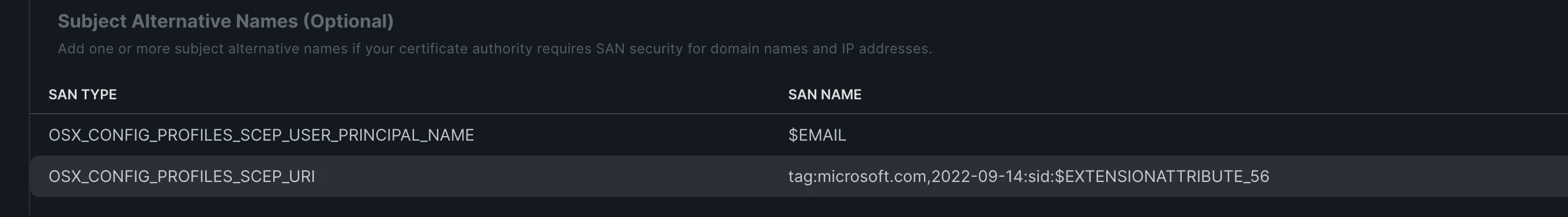

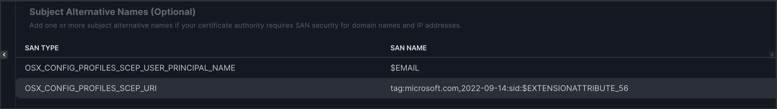

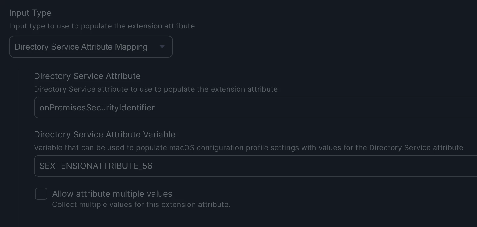

I have been successful in our test environment by adding the SID from Entra as an Extension attribute and then adding that to the certificate request.
  • Dec 18, 2024 2:04 PM UTC
I'm not familiar with that Input Type menu, where is it in the config profile? Are your Macs joined to the domain? Ours are not.
  • Dec 18, 2024 11:41 PM UTC
Our macs are not bound to the domain.
That input type is in an Extension attribute looking up the On-premises security identifier from Entra.
  • Dec 19, 2024 7:37 PM UTC
So you have Entra set up as a cloud identity provider? We are still in a hybrid environment only have LDAP integration enabled.
  • Dec 19, 2024 11:58 PM UTC
Yes, we are using Entra, you could try replacing the "onPremisesSecurityIdentifier " attribute in the extension attribute with the local AD attribute "SID" and try to see it is able to obtain the value.
Similar to CourtKPrin's question, where is the second image taken from? I'm assuming it's from your SCEP settings in your 802.1x profile stack but mine looks nothing like yours.
  • Jan 19, 2025 1:51 PM UTC
Where in Jamf is this screen shot taken from? We dont have the option in any of our instances to add additional SANS like this.

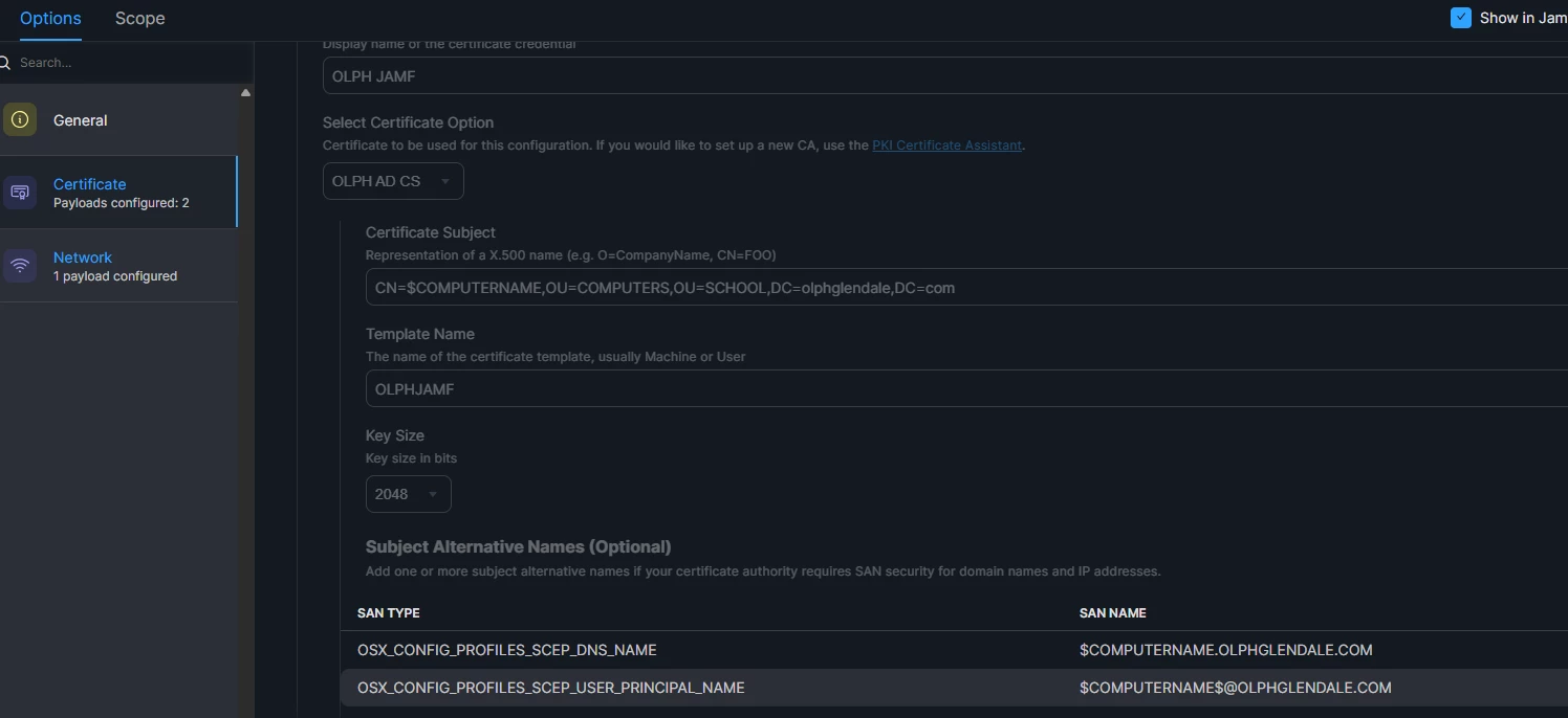

I have been successful in our test environment by adding the SID from Entra as an Extension attribute and then adding that to the certificate request.33540i19CD91FDC793E143.png33541i9D2F9303BC2C0E4E.png
I confirm these settings work, although based on a user certificate template in our case.
The AD user assigned to the jamf computer gets a certifcate via ADCS. Both SAN types pictured in the second image are needed to implicitly reference the AD user and the certificate to satisfy NPS with strong mapping enforcement. No need to update altSecurityIdentities attribute.
