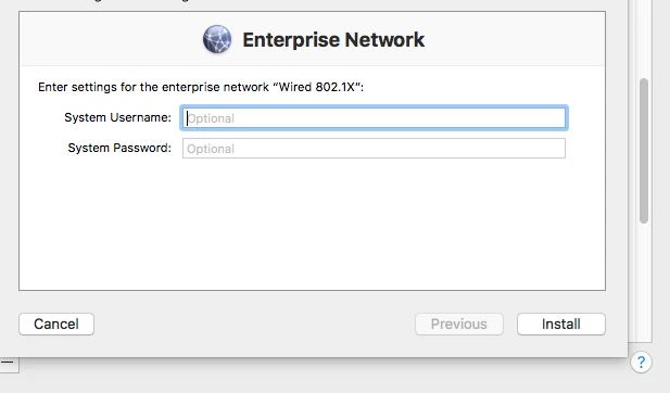

One more thing I'd like to add to all this.
It would seem that my 802.1x profile, when manually signed and uploaded to the JSS (to get around the JSS bug mangling the network payload) and deployed automatically, the autoconnection feature does not work (ie; it's ignoring my specified cert again). If I unscope my Mac, download the same config profile from the JSS and manually install it, everything works as expected. So it looks like, in order to deploy this profile, I will need to write a script to install it via the "profiles" command, instead of relying on MDM to take care of it.
This whole process has aged me a number of years, so hopefully this is the last I'll speak of it.

Hi @Kaltsas , I have some issues with wired 802.1x profile built by Profile Manager, not sure if you know what is the issue?
  • October 30, 2017
@ravigupta230290
Try removing the cert and reinstalling it with your primary ethernet connection.
I discovered this to be an issue after installing the certificate while connected to our corporate 802.1x using thunderbolt ethernet and then switching over to display ethernet. Seems like the certificate is link to the ethernet connection used during installed. For other ethernet connections, the cert will need to be manually selected.
