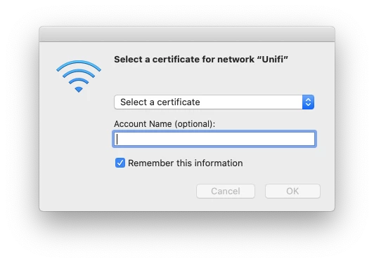

When I first make the connection I get a pop up like this:

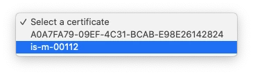

and the dropdown list contains these two choices - is-m-00112 is the machine cert
Once selected and saved this works. I'm trying to automate the setup so there doesn't need to be any user input

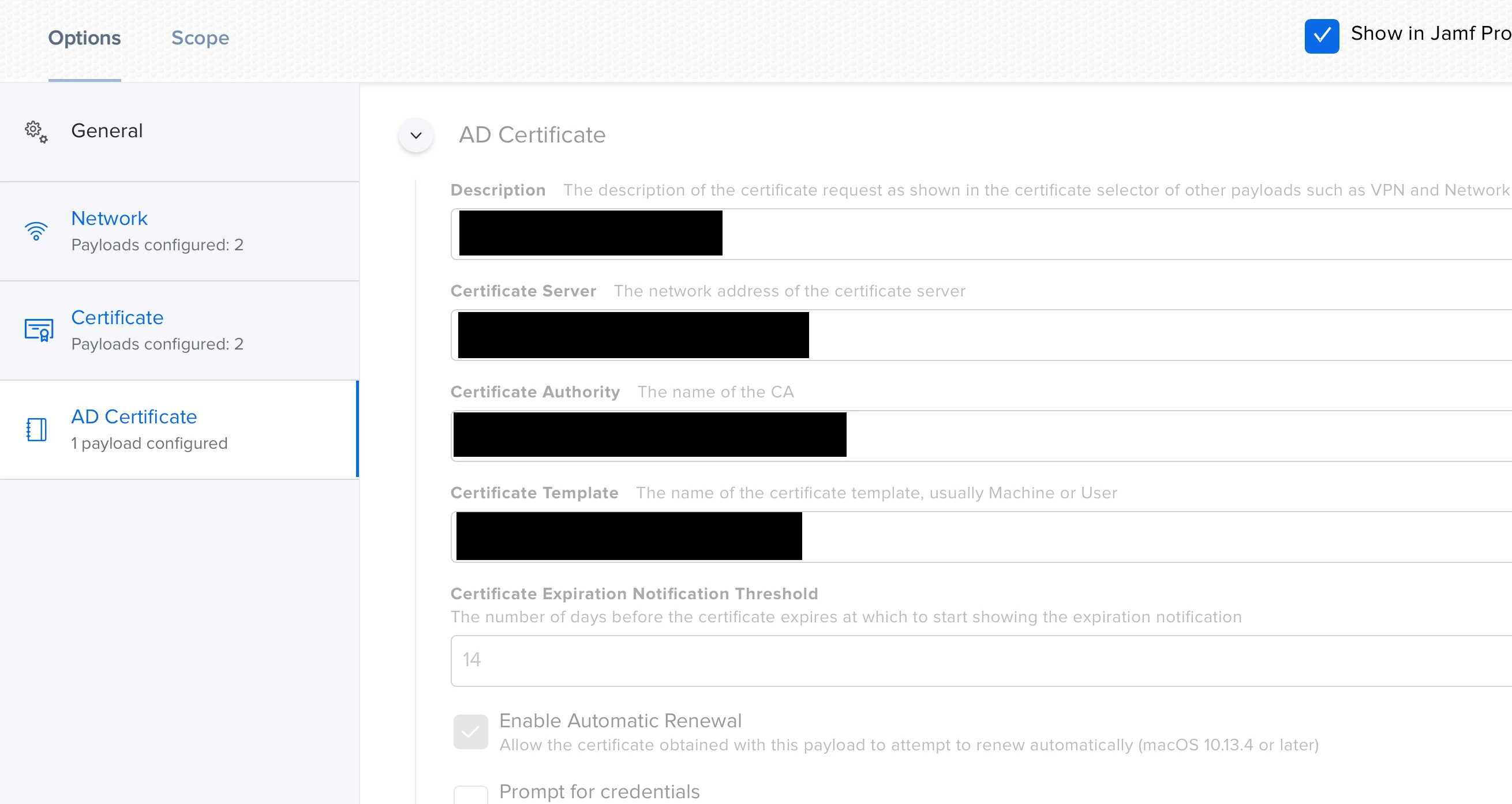

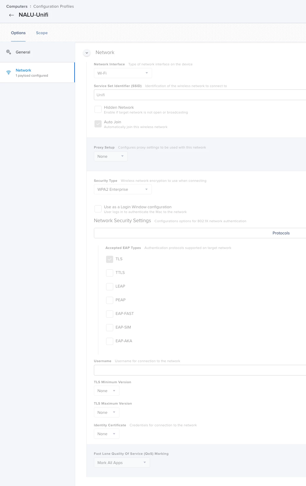

What does your configuration profile look like? Also, where is that machine cert generated? It took some playing around to get our default template correct, but we auto join 2 wifi SSIDs (depending on where you're located). The SSID info, the AD certificate pulled from a cert issuing server, and then a root cert to trust that AD cert. We auto connect without issue. I have had problems getting Big Sur to auto-connect, but I'm early in my BS testing (yes, I know it's been out a while).

Hi @easyedc - yes you are using the AD cert and for some reason we went down the path of a machine cert created using an ADCS connector.
I have gone through the motions and set up a Configuration Profile using the AD Certificate item like you but didn't get to the test stage as the network guys had already configured their rules/filters to handle the machine cert from the ADCS connector

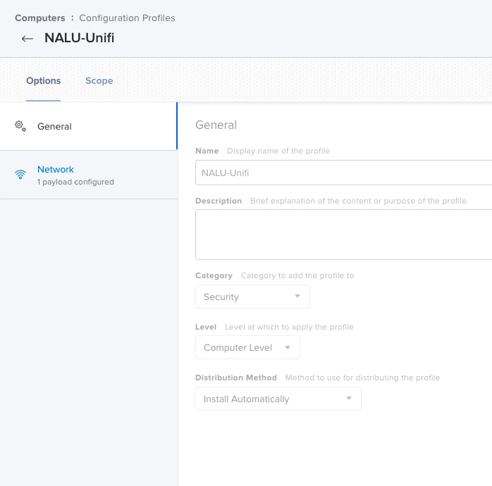

I did post the profile in https://www.jamf.com/jamf-nation/discussions/38530/802-1x-using-system-mode but here's a copy:
