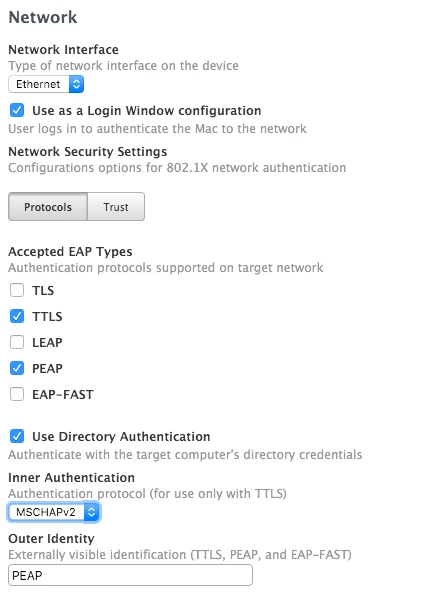

@Kaltsas If you get anywhere with this, I would be interested to hear what Apple says or if there is any way that I can use any active dongle when the user first boots the system post imaging. We use Thunderbolt dongles to image and employees have USB dongles at their desk so when they boot the system, they don't see the dropdown menu for the 802.1x configuration profile.
My setup below
  • January 15, 2016
So the way you have that profile configured I am assuming users are authenticating as themselves, not the system authenticating with its domain credentials. I say this because #D-008952 is computer credentials not sent via PEAP using JAMFs built in profiles. If they fix that I am not sure what would happen with that profile configured the way it is. PEAP with computer credentials should be set as a system mode profile while user authentication would be set as Login Window Mode. JAMF really puts a layer of abstraction into config profiles. An OS X supplicant can operate in 3 modes User Mode, System Mode, and Login Window Mode but Apple's 802.1x white paper says that System Mode and Login Window Mode can be used together. It's not clear to me what benefit this gains you since the supplicant authenticates 802.1x with the user supplied credentials and then against the directory with the user supplied credentials. I would revisit your configuration to make sure exactly how you want authentication to happen so you don't run into any surprises when/if JAMF fixes that defect.
Because JAMF has defects in the network payload for both PEAP and TLS certificates I have hand made profiles, signed them, and uploaded them as read only. This is mostly working as expected. I have gone with the extra moving parts of TLS certificates because in this configuration any user can still select the machine certificate as the identity credential on additional ethernet interfaces. With a PEAP profile additional ethernet interfaces are dead in the water.
At any rate a system mode network payload that would normally have a drop down selection at the login window won't show up at the login window on additional ethernet interfaces because of the OS X bug. Applecare Enterprise has replicated the issue and it has been sent to product engineering but we are not expecting a fix before 10.12. I have portrayed the issue to our Rep and SE and have tried to make clear to them that an expectation of enterprise would be that a system mode network profile should apply to ANY active ethernet interface, not sure how much extra traction that gets me though.
