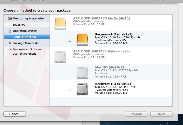

I am trying to create OS image by using target mode. But when I open composer it gives me no option but only the recovery HD is clickable.
Can you please Help.
Thank you

It sounds like you may be using the wrong app. Casper Imaging is for imaging computers (from Target Disk mode or otherwise), Composer is for creating packages.

@lama, just to clarify, did you boot the computer you want to capture the OS image of from either an external drive with Composer or put that computer in target disk mode and connect to another computer that has Composer to use to capture the OS? If you are running Composer from the computer that you are intending to Capture the OS from you can't do that.

It has been a while since I used that method. (Now using AutoDMG) Lets clarify what you are trying to do... You have Composer of a 10.8.5 Mac and want to create an image of a 10.10.2 mac via target disk mode. One thought is the 10.10.2 mac is FileVault protected and you need to unlock the drive. Also, try having your mac with Composer on it be on the same OS as the image you are trying to create. i.e.: (Both Macs on 10.10.2) Lastly if you are trying to create an untouched image I would HIGHLY recommend AutoDMG, however if a modified thick image is your goal hope this helps.

If you are running Composer from the computer that you are intending to Capture the OS from you can't do that. !!!
Thank you So much I think I was using OS 10.7 and trying to build Image 10.10.4 (with was in Target mode)
I did not know that you have to have exact same OS to create image for 10.10.4
Thank you very much
