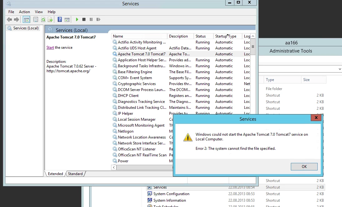

  • July 17, 2015
Error when upgrading...
chris_kemp
Forum|alt.badge.img+20
  • July 17, 2015
I had persistent problems installing the Betas, as well as the release on Windows Server. The only fix that worked for us in Dev was to remove the JSS via Control Panel and then run the installer. It reconnected to the existing database, and it appears to be OK except there is an issue with Filevault Recovery Keys that we're trying to assess right now.

  • July 17, 2015
I'm seeing this as well on our test server which runs on Windows Server 2008 R2. Troubleshooting this morning.
EDIT: Have a support case opened and working through some recommendations. Will update if something worthwhile turns up.
  • July 17, 2015
@chrisbju I ran into this problem yesterday when upgrading. I backed up the C:Program FilesJSSTomcat folder to a safe place and then deleted the Tomcat folder. Restarted the JSS upgrade and everything installed and upgraded. I also had to put the certificates back as well after I was done. Probably not the best method but I was in panic mode! 9.73 has been working great so far after the install snafu.
