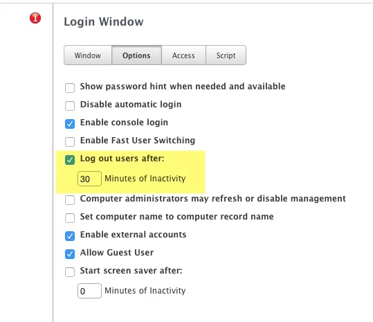

We did the upgrade from 9.73 to 9.8 (running OS X 10.10.5) without problems. But a curious new issue affected some computers during the lunch break: the logged in user was logged out after x time of inactivity. Those with unsaved documents weren't, because a modal dialog stopped it.
Finally I found out, that a configuration profile was altered on a way I can't explain. I edited one yesterday after the JSS update to update the banner with the new JSS version. But at "Configuration Profiles > Login-Window > Options >" Log out users after 30 minutes of inactivity was checked...
@Apfelpom That was in the release notes as a bug fix. Previous versions of the JSS were not logging users out when that was checked. I would guess that it has been checked for quite some time, but due to that bug, no one ever noticed.
I'm actually excited to upgrade due to them fixing this bug in particular.
I'm having some struggles getting our Dev server updated - our servers are still running Server 2008 R2. I'm getting an error from the installer during the "Upgrading web app and starting up Tomcat7 service..." phase that reads "There is a problem with this Windows Installer package. A script required for this install to complete could not be run. Contact your support personnel or package vendor."
@mscottblake: Good to know that the user logout after x feature now works. I looked inside older deliberately zero scoped profiles with Login Window settings and they all have the 30 minutes box checked. Even a new profile in JSS 9.8 with Login Window settings is set per default to log out users after 30 minutes.
Could somebody verify the default state of the box "Log out users after:" before updating to 9.8? Thanks :-)
I can't seem to install the 9.8 JDS on OS X 10.10.5 with Server 5.0.3 already installed. The JDS installer balks at the perceived lack of Server having been launched once and "set up."
@Apfelpom Defaults in new config profile just created in 9.73:
Thanks @Josh.Smith! The defaults are the same in 9.8.
Funny defaults by the way: the automatic login is enable but 30 minutes inactivity later, the user will be logged out. If he failed to remember his login credentials, he will have the choice to take the guest user or to restart ;-)
@mscottblake Me too, this bug was really annoying. Do you know if this is still not a forced logout, i.e. will fail if apps need attention?
