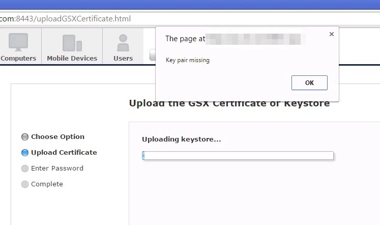

Has anyone tried 9.8 and uploading their Apple provided GSX certificate?
I did so last night, and got an error stating that the key pair was missing. (see attached)
I already emailed Apple GSX support, but just thought I'd throw this out there to see if anyone else was experiencing the same...

Does Step 3 in the KB for GSX help? https://jamfnation.jamfsoftware.com/article.html?id=26
It looks like for a CSR that is not generated in the JSS for GSX, directions for generating the the key-pair are shown in Step 3
  • September 17, 2015
Thanks Tom,
Did not see those instructions, but it won't work anyway, as when I dragged the cert into Keychain Access, the private key is missing.
Guess I gotta generate a new CSR and deal with Apple again.
