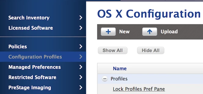

I've updated from 9.72 in our test environment to 9.81. One thing I've noticed is that I don't have the ability to add ("+" button) configuration profiles for OS X devices. I can edit existing profiles but no provision to add. I have that ability for the iOS side. Anyone else see this or is it just my environment?

@Brad_G While I know it should not have been affected or changed, have you gone in to look at the privileges enabled for the account you log into your JSS with? Its possible the option to create Config profiles moved or changed in some way and just needs a check next to it to show up. Missing features after upgrades are kind of common because new or modified privileges don't get enabled automatically for accounts.
@Brad_G I know the Config Profiles New button disappears if you have Enable Push Notifications unchecked in the Security Pane of Computer Management.
