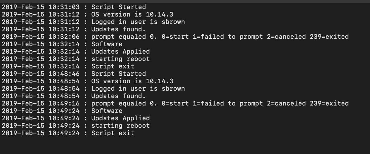

Hey guys,
First of all this is awesome. I'm so pleased people are looking at other ways to update machines. I'm running a fleet of 150+ macs and Jamf don't seem to have an awesome for updating them all (patch management certainly doesn't work!)
I've just jumped onto your github @Taboc741 - pulled the files down, updated the paths etc. Everything seems to be working, however the script doesn't seem to know that I don't have any updates pending. It goes ahead and tries to "update" the machine... and then restarts it! I can't see any reason why the script doesn't stop when it sees there are no updates to do. Any ideas?
Packaged up the file with composer and installed it before running the script. - everything works as expected from what I can see.
FWIW I ran the script from self service because I believe most of my users will do that.

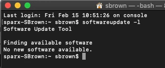

Out of curiosity, is there a reason the LaunchAgent is running at a particular time rather than just letting Jamf call it when necessary (ie. software updates >0 type thing)?
  • February 15, 2019
@samuelbrown I should probably add 'sendToLog "$updates" ' arourd line 31 or so. That would output the string to the log that the following 6 lines is trying to parse to determine if there is an update pending to install. If you add that and then post the resulting log I could figure out how my logic is broken and resulting in the script trying to install updates that aren't pending.
@jwojda The defer process was built to run independent of Jamf. That way I am not waiting on machines to submit inventory, which we run weekly to help with DB maintenance, for a machine to fall into a smart group to then be pestered about installing their updates. You could certainly swap up the process, having Jamf trigger the defer script rather than the launch agent.
ImAMacGuy
Forum|alt.badge.img+23
  • February 15, 2019
@samuelbrown @Taboc741 The test machine I ran it on had the opposite problem, we had an update available, the only option I had was to install it. After the script claimed to download the update, install, and then reboot only to find the update never installed.
  • February 18, 2019
@jwojda I have had that happen once in my testing. I tried running the script a second time from the terminal window so I can see all the stdout context...and then the update installed, and I have not been able to reproduce the issue. I added the --force to the softwwareupdates command just incase though. Someone on slack suggested using the softwareupdates restart process every time which might work for you. In my testing I had issues with some macs trying to re-install the updates a second time and taking a really long time about it in the reboot portion of the script.
