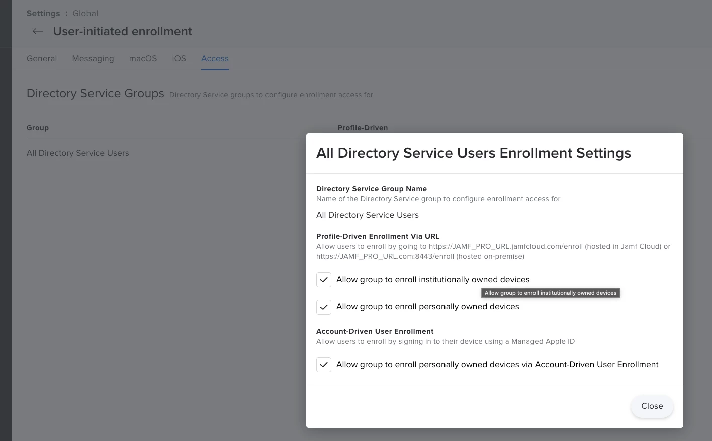

Hello,

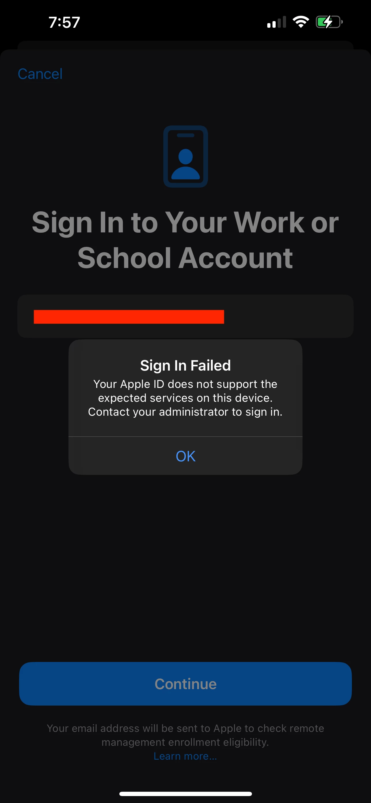

We are having issues enrolling BYOD devices in Jamf Pro using Account-driven BYOD Enrollment.
We are following the instructions on Jamf documentation but we are receiving an error for any Managed AppleID that tries to sign in:
"Your Apple ID does not support the expected services on this device. Contact your administrator to sign in"
All of our Apple IDs are managed and the domain is setup in Apple Business Manager. We have a ticket open with Jamf Support but wondering if anyone else has had this issue.
Current configuration:
This has worked before. We had these settings turned off for a while while we investigated (about 1.5 months).
iPhone 13 Pro Max running iOS 16.4.1.

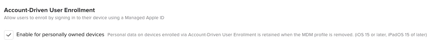

  • Sep 25, 2024 10:29 PM UTC
I am able to host the json file, and get the `
curl -I https://yourcompanysite/.well-known/com.apple.remotemanagement`
return with 200 response and application/json but it still shows user error
I tripple checked the user-driven account enrollment is ENABLED. anyone has any idea what else went wrong?

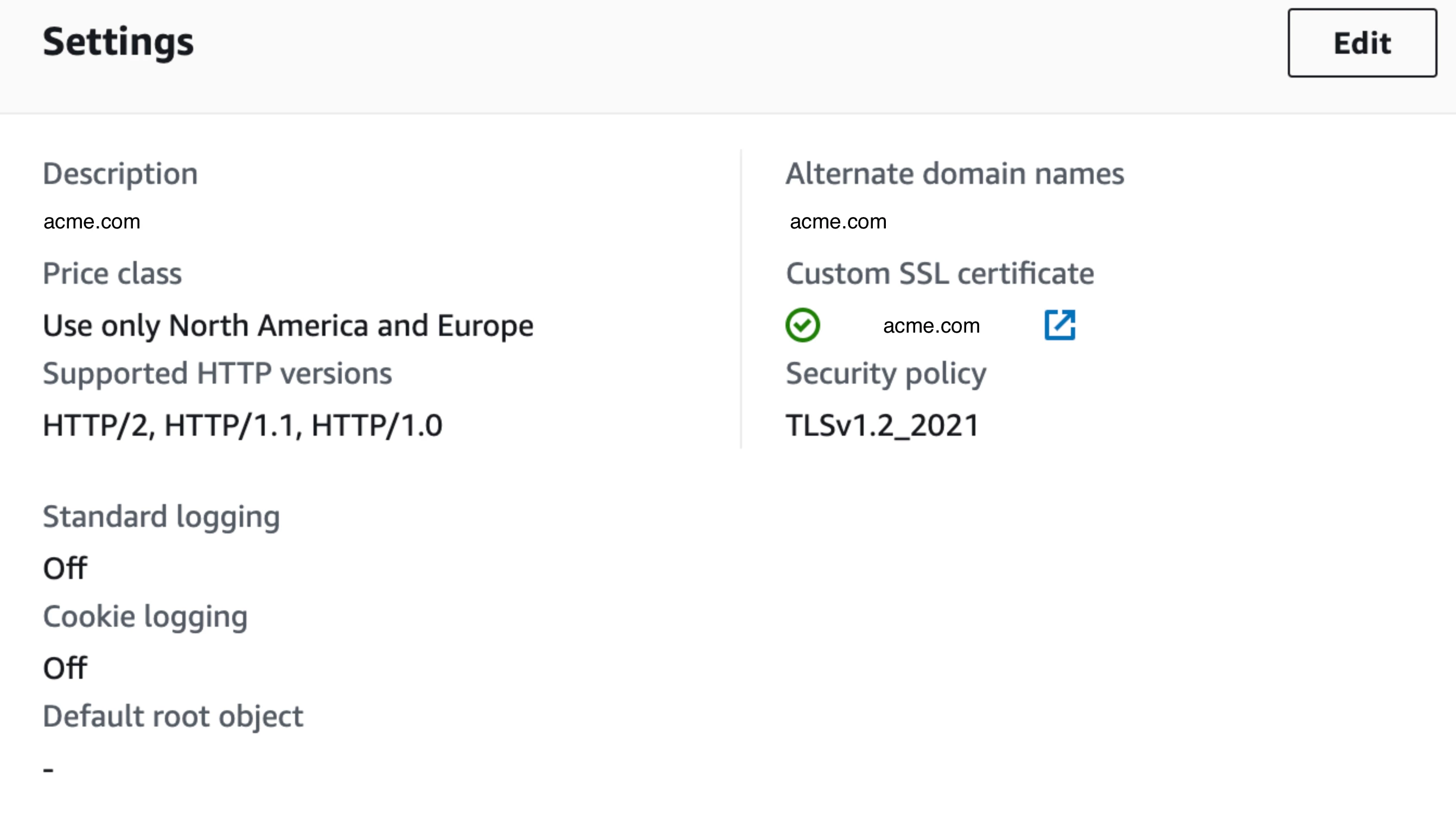

I thought it is worth to share how we implemented the hosting on S3... My DevOps did put a guide together how we did it. Likely I will not be able to answer on details.
Setting up Account-Driven User Enrollment involves creating and hosting enrollment information in a JSON file on a web server. This allows devices to initiate a service discovery process to retrieve the information and direct the user to the enrollment portal on their device.
To host the Jamf Pro enrollment information on a web server, the following AWS resources are required:
Create an S3 Bucket:
Follow the guide here to create an S3 bucket that will store the configuration JSON file. Name your bucket after your domain name.
Rename your JSON file to com.apple.remotemanagement.
Create a folder named .well-known and upload your file to this folder. Ensure that the file type is shown as remotemanagement.
2. Create a TLS Certificate:
Follow the guide here to create a TLS certificate in the us-east-1 (N. Virginia) region using AWS ACM. This TLS certificate will be used with the CloudFront distribution.

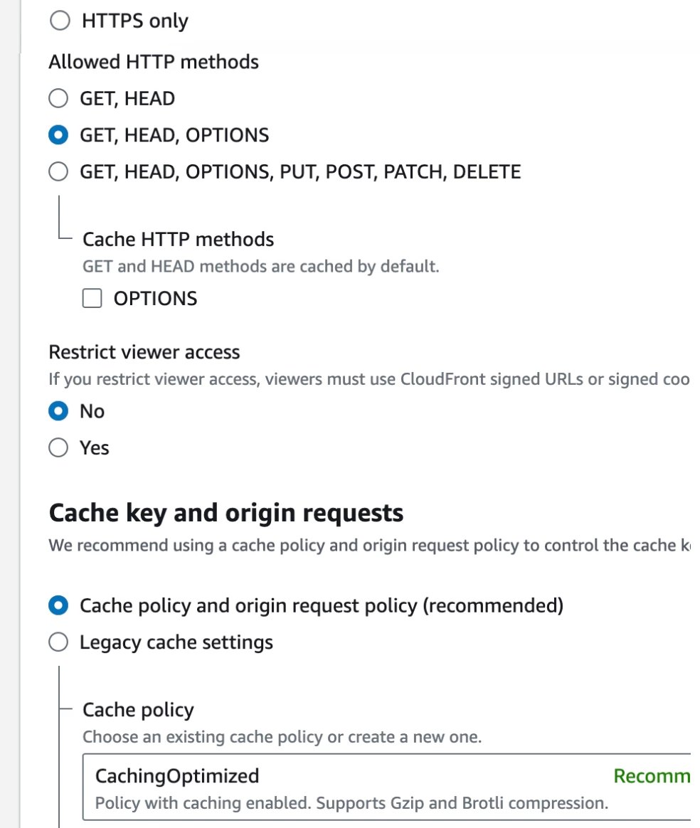

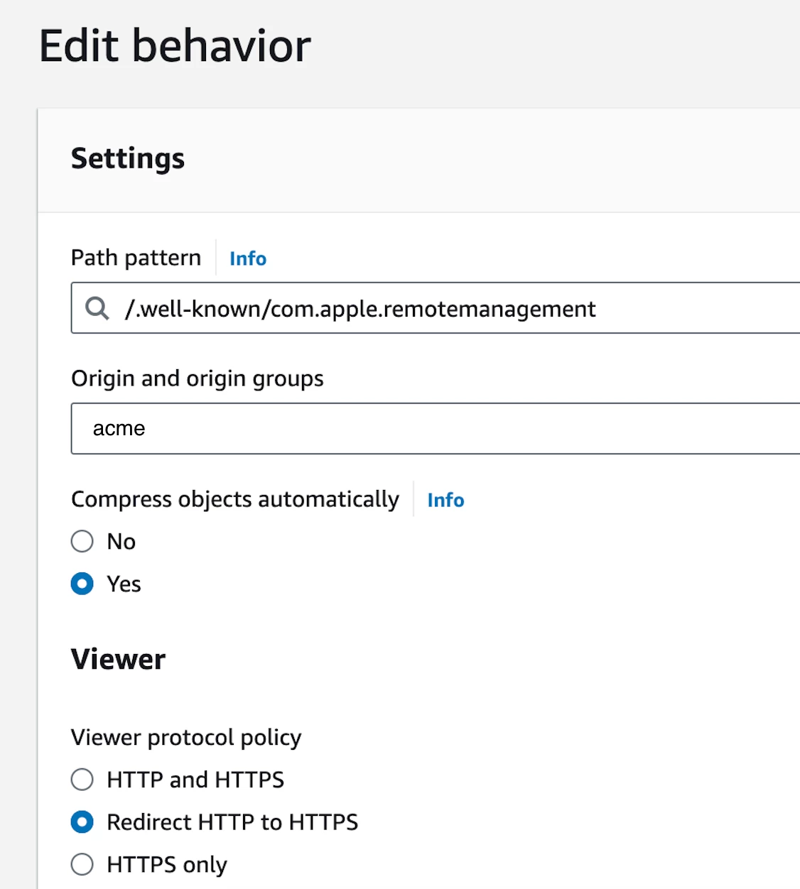

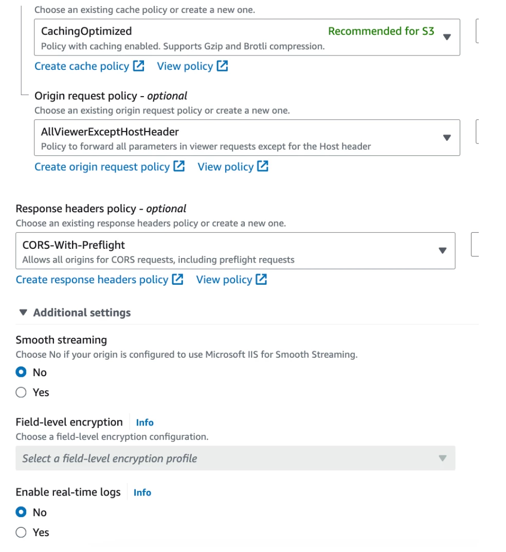

  1. CloudFront Distribution:
  • Follow the guide here to create a CloudFront distribution that will serve as an endpoint for the configuration file stored in the S3 bucket.
  • Add an origin:
    • Choose the S3 bucket created in Step 1.
    • Select Legacy Access Identity as the origin access type and choose an OAI from the drop-down menu. This OAI will be used in the S3 bucket access policy, which will be updated in the following steps.
    • More info here.
Update the TLS settings:
  1. Edit the distribution settings to an alternate domain name.
  2. Choose the TSL certificate created in Step 2.
  3. More info here.

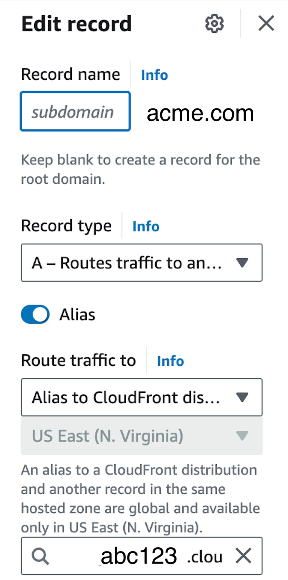

  1. Update Route53 DNS records:
  • Create an A record to alias a resource under the hosted zone of your domain.
    1. More info here.
