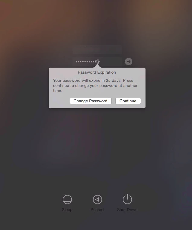

What's up Group!
We've searched for this high and low and we've read multiple topics on AD here at JAMF. We were was wondering if anyone knows how to disable/kill the AD password expiration prompt our users get when they log into their machines?
We'd like to use the ADPassMon utility going forward for password changes that a bunch of you have praised and suggested using. We are pretty much FED UP with how AD and Keychain don't get along! Any thoughts? Thanks a bunch!

@monaronyc just out of curiosity, what makes you want to remove the prompt? If a user's password is going to expire soon, isn't it better they know so they can take action?
  • December 3, 2015
@bentoms EXCELLENT! I was a little skeptical with the screenshots being we're Yosemite but I just tried it and it worked! THANK YOU! THANK YOU! THANK YOU!
@davidacland We've been inundated with Keychain problems more than we know what to do with. It stems from users changing their passwords from the prompt above in the screenshot. If they change their passwords there, Keychain is a mess. Computer becomes unresponsive due to all the keychain login prompts. If we disable it, this will force them to use the ADPassMon menu to change it where it should to be changed.

@bentoms Thanks for sharing this! Just out of curiosity, how are AD users notified that their password will be expiring if this prompt is suppressed. I'm entertaining the idea of suppressing it as well because of the disconnect it causes with the Keychain, but I'm afraid users won't "know" to change their password and will need to call our IT Service Desk more often due to account lockouts.
  • December 4, 2015
@monaronyc I had the same problem I ran the following script on all computers. I've not seen the password expiring prompt at login since doing this.
Our users get several emails telling them that their password is about to expire.
sudo defaults write /Library/Preferences/com.apple.loginwindow PasswordExpirationDays -int 0
  • December 4, 2015
@kish.jayson If you use the ADPassMon utility, it places a number (the number of days their AD password is due to expire) and depending on when you set the preference to notify the user, a notification alert will appear as well. So there's a few indications the user will know. But just the number itself appearing in the menu bar is clear enough.

  • June 29, 2016
Hey all...
A little late, but better later than never....right?
Is there any way to just remove the 'Change password' button in this prompt? I'd like to remind our users with the standard AD prompt at Mac OS login, but changing the password here is where the keychain issue occurs. I'd like to drive our users to the Sys Prefs/Users and Groups/Change Password. When they change the password here, keychains get updated as expected.
Thanks,
Dev
mm2270
  • June 29, 2016
@devlinford
I seriously doubt it. That pop up is generated and controlled by the OS, not a simple script, so I don't think you could remove just the button without hacking the OS and breaking something in the process.
I'd look at other solutions, like some of the ones mentioned here.
