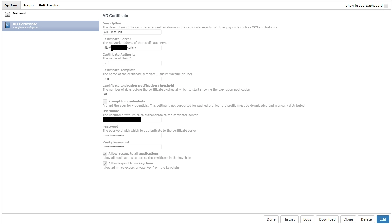

My General settings (made it availible in self service during testing period):
and my AD Certificate Payload:

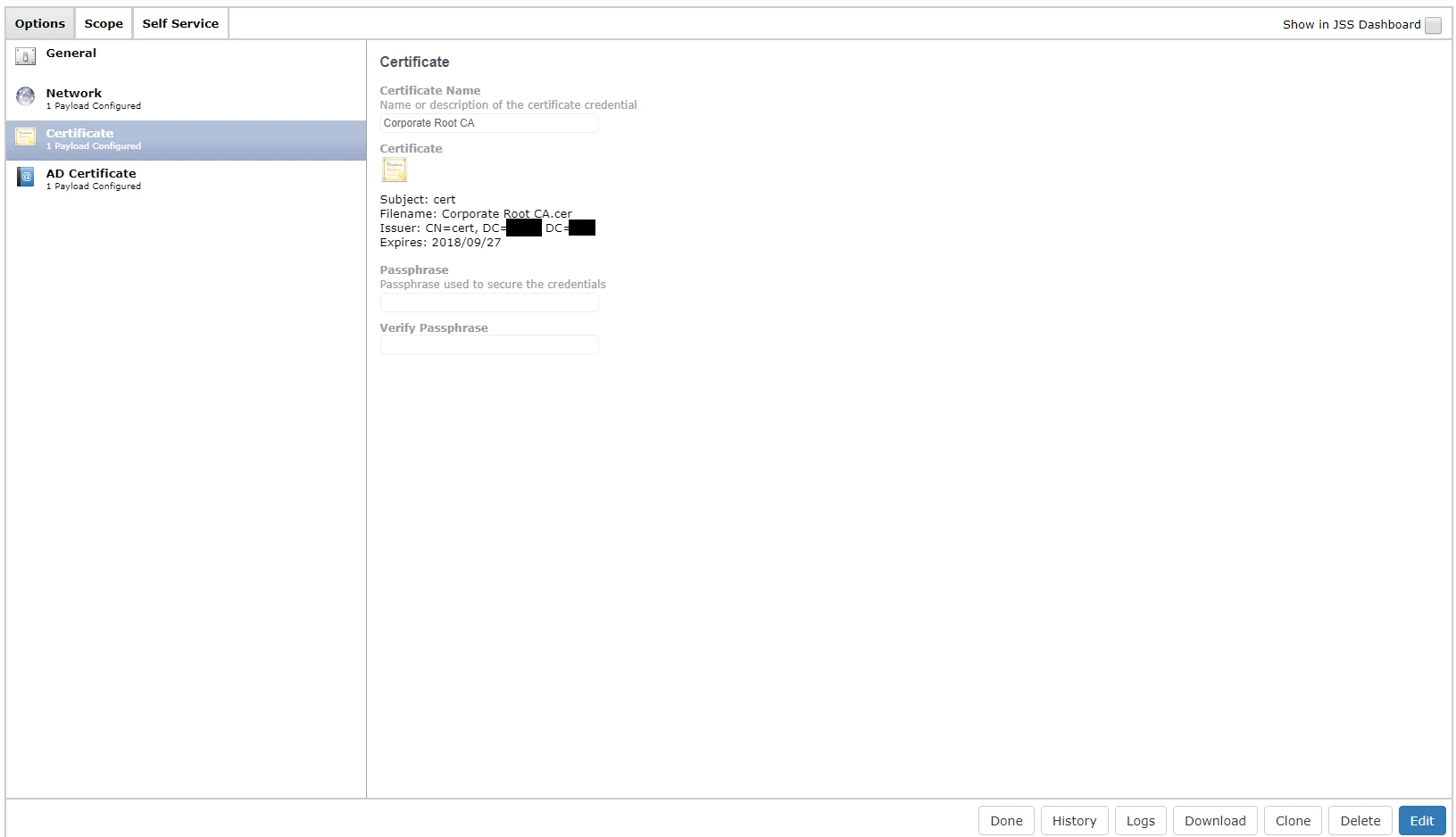

@Berrier I've now tested it and it doesn't help... I am not sure what the "Intermediate CA" is so I will ask our Certificate guy if he can help me out with that, as far as I can understand the Root CA validates the Intermediate than later validates the others?

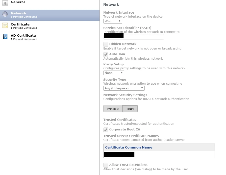

This is my Settings at the moment:
And also the Network payload trust section:
Thanks!
PS. This does make the root certificate trusted, but not the AD Certificate.
