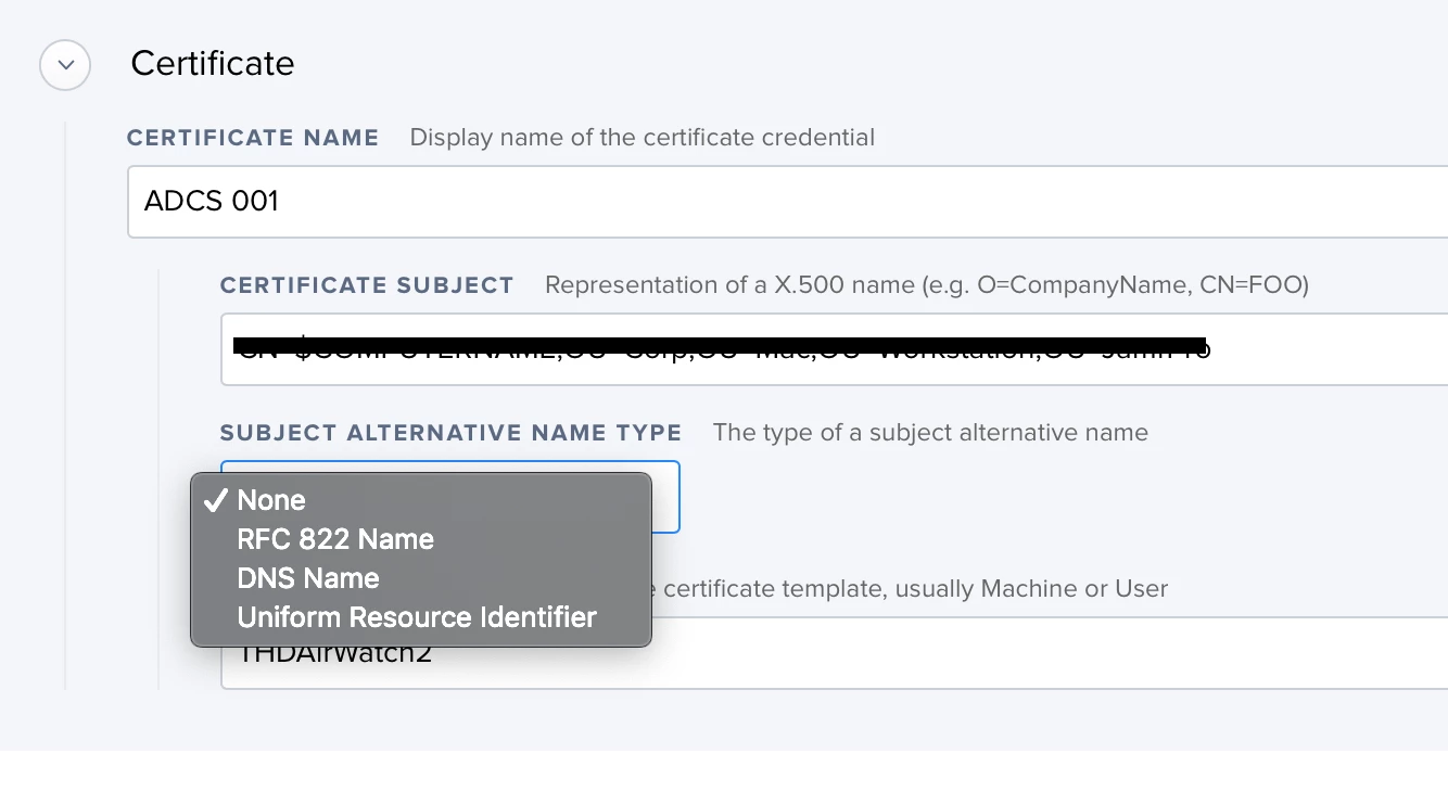

Ok I see. Is SAN supported or only Subject ?
  • December 12, 2018
