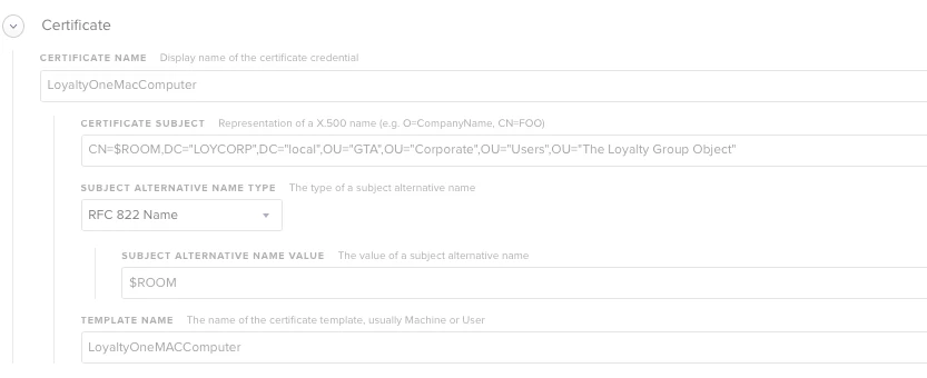

  • August 31, 2018
so I've finally got mine to work 100% the way I need it to... I'm using a computer cert that is fully populated with all the details as in our user certs. This deploys properly with adcs. We have our windows 10 computers authenticating using a computer certificate and our Macs with a user certificate....

  • September 21, 2018
take a look at my cert setup.... these fields match my user based certificate...
Thanks for the assistance I was able to get it work but there are a few things i am not sure on.
If you are taking a Computer template and populating it with user attributes ($ROOM in your case) aren't you just making a user certificate since the only difference between a Computer and User template is the default Key Usage ( Extensions). When you populate it with computer details ($COMPUTERNAME.domain.com) you are making a computer cert and you will not be able to authenticate because it is not binded to a domain (as far as i can tell you have to be connected to a domain for a machine certificate to work).
From my testing it seems like OSX does not requires a computer certificate for pre-logon authentication and seems to work fine with a user certificate? On Windows i think it had to be a machine certificate.
I got mine to work with out a Subject Alternate Name which seems to contradict the NPS requirements (https://docs.microsoft.com/en-us/windows-server/networking/technologies/nps/nps-manage-cert-requirements) so im not really sure how is working but it is.
