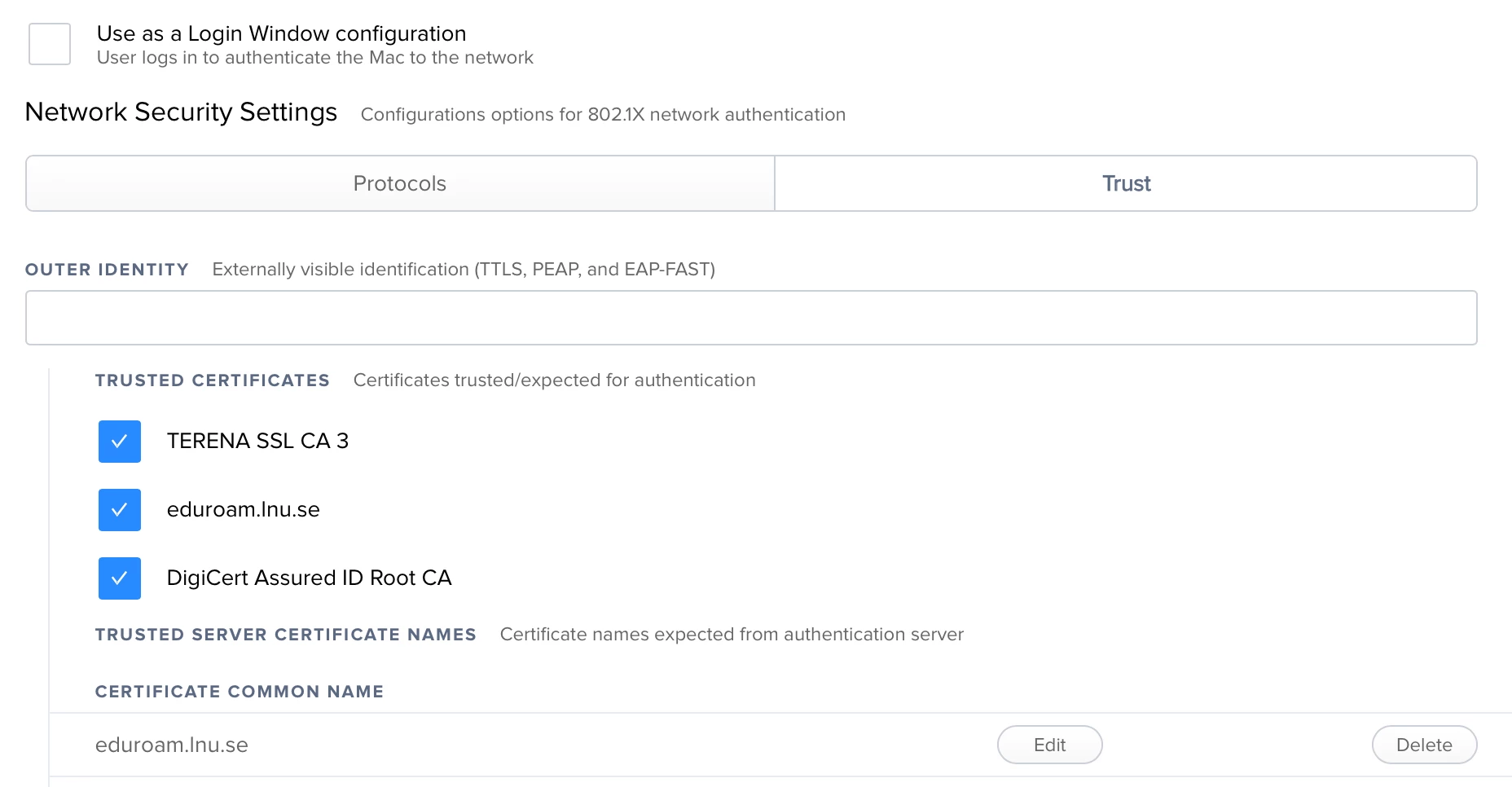

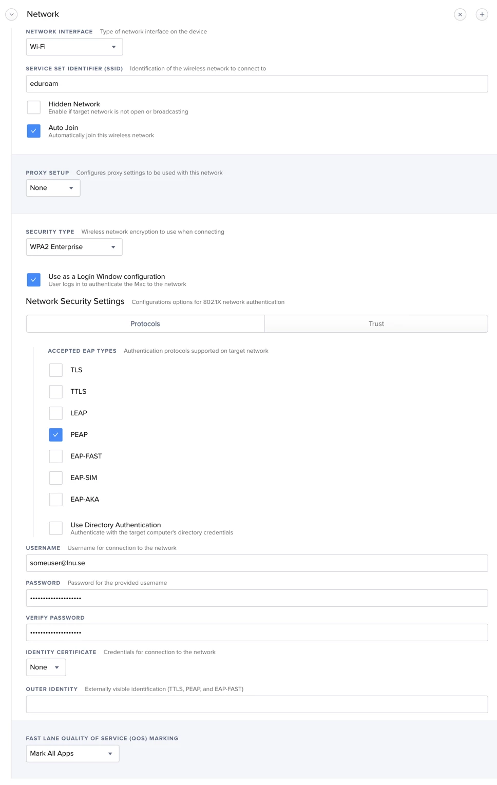

I am having a little bit of trouble creating a working Configuration Profile that enables a new user to log in via eduroam Wi-Fi on Mac that is already bound to AD.
We always use the network cable when a new user logs in. I want to get rid of the cable :)
I managed to have the new user log in (via WiFi) but after the user logs out and logs in again the wifi is not working anymore.
The 802.1X, theoretically shows that is connected because the button Disconnect is present.
But I don't see that usual text as I see it on other Macs: "Authenticated via EAP-PEAP (MSCHAPv2)"
I need help :) What am I doing wrong?!?

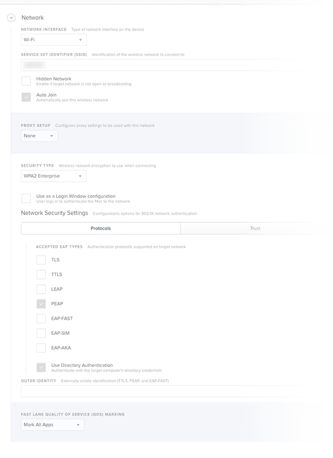

@remus If you want the Mac to be on 802.1x WiFi with no user logged in you have to enable Use Directory Authentication so it'll use the machine'AD credentials to connect. Turn off the Use as a Login Window configuration as that won't work if the user is required to change password on 1st login. When a user logs in the machine credential connection should drop and the Mac will re-connect with a user authenticated connection. When the user logs out it goes back to machine mode. Note that if you're using FileVault 2 the Mac is not going to be on the network until a user logs in as you're in a separate OS partition at the FV2 login screen.

My profile looks like this:

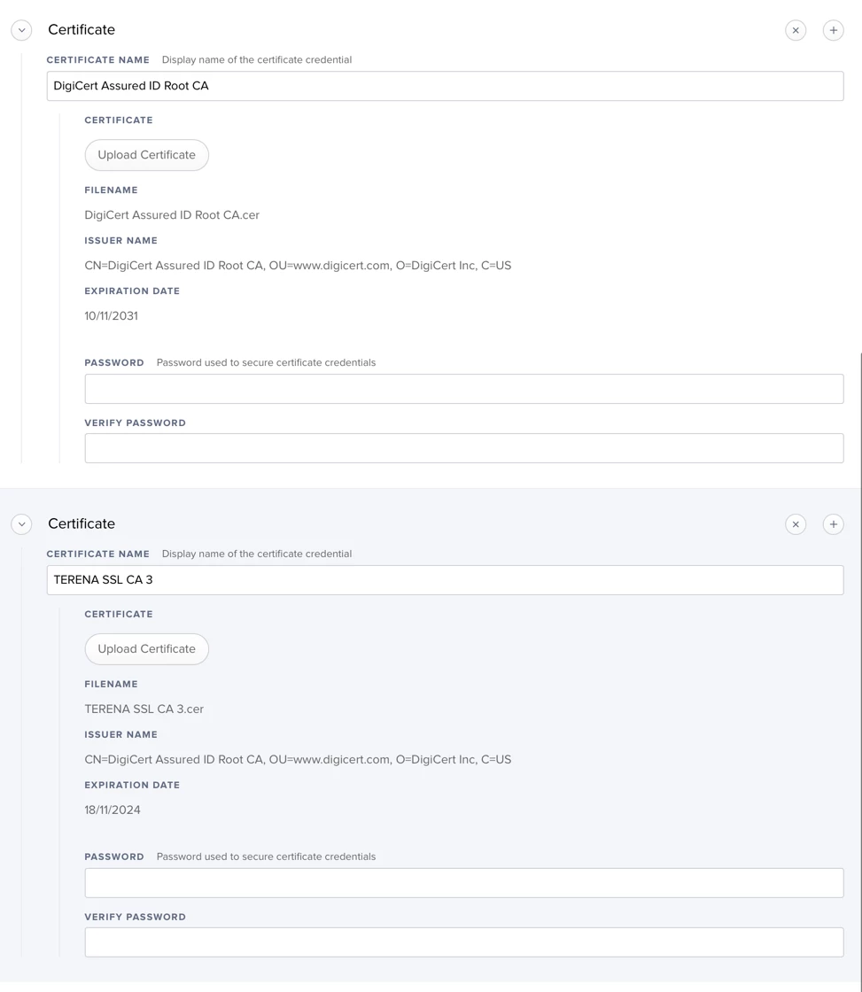

I have our Cisco ISE certs as a payload in the profile. I am also trusting our Cisco ISE certs and also *.ourdomain.org in the Trust section.
This is set as a computer level profile. This allows the Mac to authenticate to wireless as the Mac's AD computer account.

We use Cisco ISE, and we have ISE using a digicert cert, which is generated from digicert. We have a wildcard cert from digicert so you clone that with ISE's SAN name. We also have the Digicert Trusted Root cert, and our wildcard cert in there too. It would be the full certificate chain. It might not be necessary for all three but it does not hurt.
Also, I am trusting all the cert names in the trust section, as well as *.ourdomain.com, and I am not Allowing Trust Exceptions as I don't think that would work on a system profile.

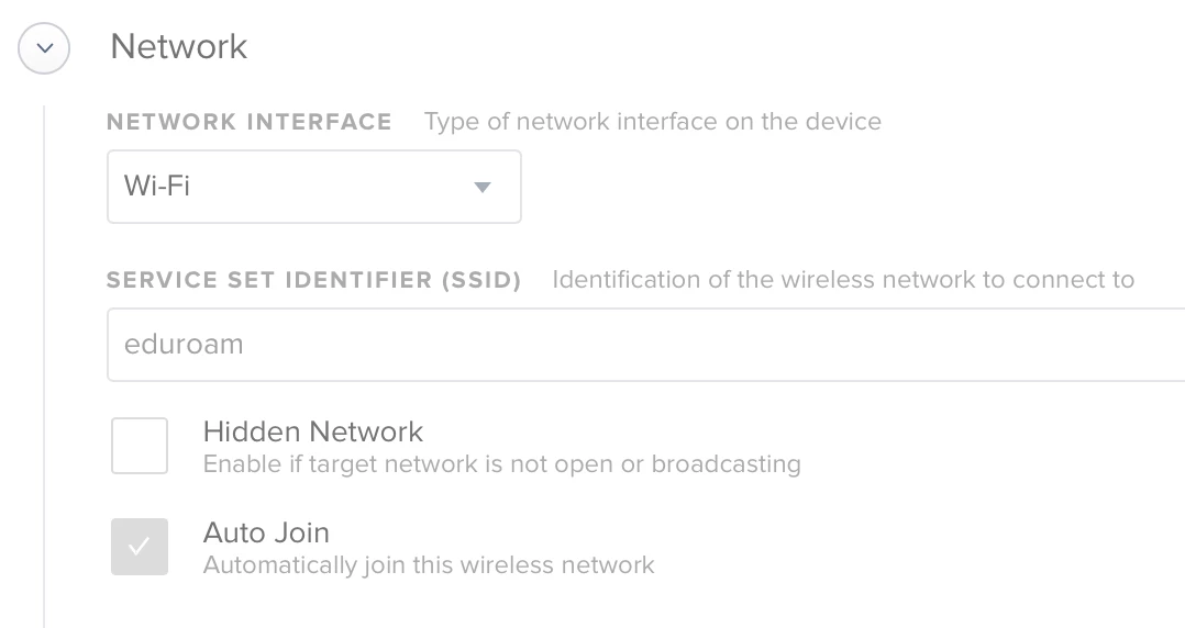

You might check whether "Auto-Join" is checked, and that the profile did successfully update it's settings. Modifying WiFi profiles is very tricky, and usually requires profile updates to push over a wired connection with WiFi OFF in my experience.

I'm getting almost an identical issue to @remus I am able to manually connect to our wireless network with no issues, but when I go ahead and make the configuration profile I seem to get stuck. I noticed differences in the wireless settings when I connect manually and when I push out the profile. Below see my settings and some screenshots.
If anyone knows a way please let me know. I would really appreciate it.
