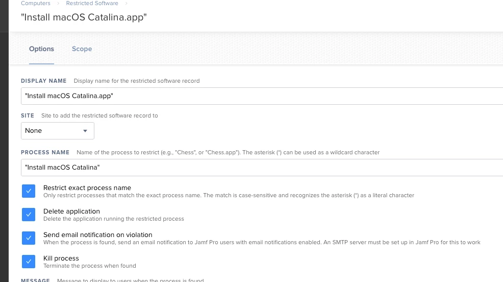

I downloaded Catalina from App Store, but when launching it should block with restricted - but it works fine ? As far I can see I use the same as example above ?
  • October 8, 2019
Remove the "" from your Process Name:
Process Name: Install macOS Catalina or use Install macOS Catalina.app

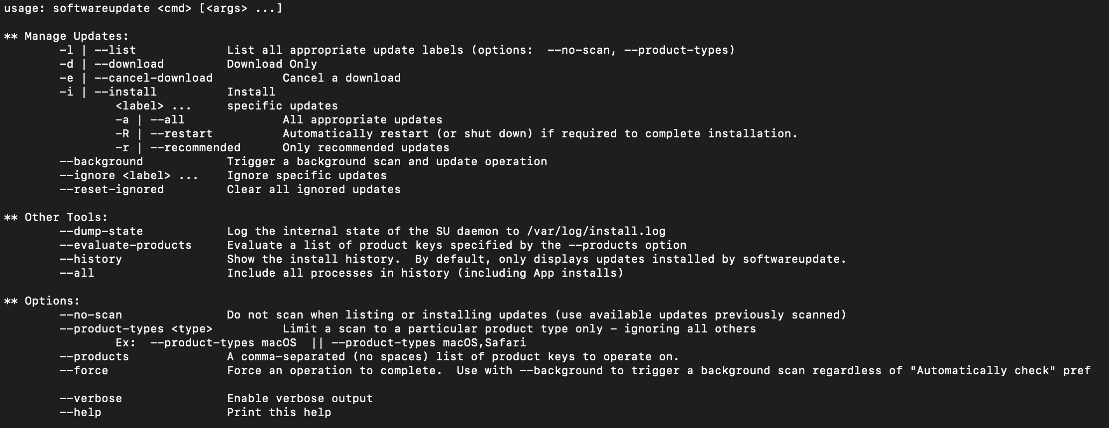

@jzarate or remove it all together from Parameter 4 and use the script for other updates in the future.
Also to double check what updates are being blocked use:
softwareupdate --ignore

@jameson This might be anecdotal but my restriction process (10.15.1 on prem) did not honor my use of wild card at the tail of "macOS Catalina" and I needed to explicitly define the .app (ask me how I found out). This had been working fine with beta tests on the previous 10.11.1 instance so I am unsure if this is an environmental thing or an issue with the product but the tl;dr is make that change and force a management refresh on endpoints along with the update suppression and you should be good.

So I tested this a while ago using Restricted Software on my test machine and I was happy with it, but was horrified to learn today that somebody had upgraded to it.
I then downloaded the update on a different device and it ran straight away no problems, then I went off to do something else, came back, and it was now being restricted when I attempted to run it.
Although the setting in Restricted Software was correct, it turns out that the devices in scope will need the Management Framework to refresh in order for the setting to apply (https://macmule.com/2019/10/07/blocking-macos-catalina-with-jamf-pro/#There_is_no_step_2). I don't currently have a policy to do this so will need to look into it, but for the meantime I will use the route of ignoring the update.

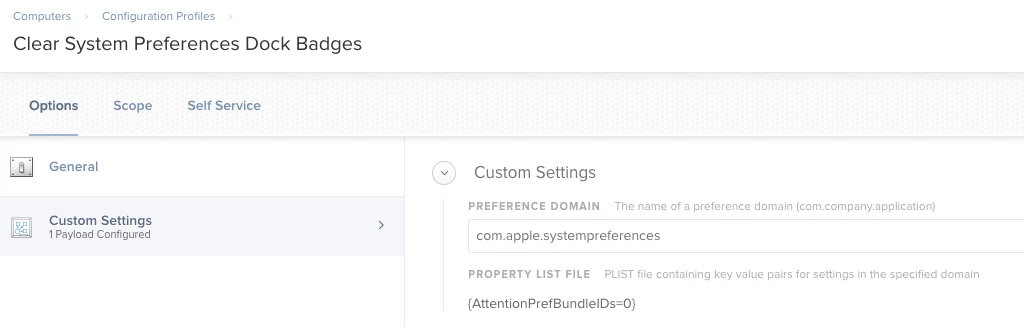

Next step - Anyone know how to get rid of the red 1 bubble in system preferences dock icon? :D
  • October 9, 2019
@rodders I set up a config profile with a custom setting and the following plist. I tried scripting this but the icon would be refreshed on a regular basis.
i put the config profile into self service since it will block all system preferences notifications and I wanted it to be Opt in.
The issue i'm running into is that users need to either restart, or do a killall Dock before it actually takes effect.

  • October 9, 2019
@rodders trying to see if there is another way then a custom profile route as this blocks all update notifications if I am not mistaken.
  • October 11, 2019
@strayer I tried your Configuration Profile above using the plist. The profile loaded, but I'm still seeing the badge even after reboot. Any suggestions?
  • October 11, 2019
![optional image ALT text](
I installed the profile at a system level and then ran
killall Dock
and the effect was instant and the icon has not returned. I did have to convert the plist to an xml before it could be uploaded to jamfcloud using
plutil -convert xml1 /Path/To/com.apple.systempreferences.plist
  • October 11, 2019
@strayer, I was missing the correct Preference Domain. That did the trick, thank you!

If we use the script, is it a simple process to revert it back so we can allow people to download Catalina once some of the bugs have been repaired?
  • October 28, 2019
--Reset-ignored will remove all ignored updates. Here's a list of the rest of the commands.
