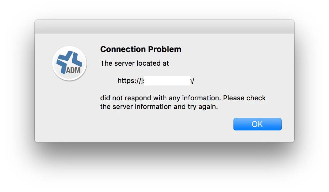

Has anyone seen this? I just updated to 9.99 and now I get this error when trying to connect with admin. All seems well otherwise, can download/install packages, etc.
Did you check (uncheck) the cert verification box when launching Casper Admin?
Also...from the machine you are trying to launch Casper Admin on, can you manually mount the DP?
Finally, as a sanity check, can you get to the JSS via the web on the same machine you are running Casper Admin on ?
I have checked/unchecked the box, no difference.
I can manually mount the share.
I can connect to the JSS web no problem.
All the apps fail to connect though (Admin, Recon, Remote, etc)
Try holding down option key while opening Casper Admin...repopulate your server info and try again. Maybe a inadvertent typo?
No luck
Taking a very careful look at your picture I think I see the problem ...you blotted out your URL but not so that I couldn't see that the last character is a letter not a number. Unless you have a highly advanced confit or a JAMF hosted config, your URL will likely take the following form:
https://<yourjssurlhere>:8443
the key is to not forget the :8443 at the end.
Unfortunately we do have a crazy config. They're all behind load balancers and that should be the correct address.
That's ugly and I made sure this time to look at your JamfNation profile... you've been through CJA so unless you were just not watching, you wouldn't have made that mistake. A version mismatch wouldn't have blown that error. Would it be a JDS problem maybe ? I'm not as familiar with a JDS. You may be doing file shares anyway.
I'd swear the last character in your server address from the pic was an "n" with a slash. I could be wrong. Maybe leave out the hard slash at the end? Maybe your firewall guys have been working unbeknownst to you? Maybe for sanity try using Casper Admin on a different workstation?
The address is correct, and the app adds the last / on whether you enter it or now. We're on a File Distribution Share, no JDS. I've tried different workstations. Can't quite grasp this one. Already opened a support case, we'll see what happens.

I just started experiencing this issue yesterday afternoon. We're on 9.96. The WA works, everything seems to be configured correctly, and I rebooted the DB server this morning. Admin and Remote are the tools that don't seem to work. Additionally, I verified that the distribution point is accessible. I will be placing a support ticket with jamf today.
This turned out to be a bigger issue for me. My DB ended up partially corrupted because of the update crashing due to lack of disk space. I ended up restoring the DB after clearing up space, which seems to have fixed the bulk of the problems.
After rebooting the WA, which was working but wonky, my instance seems to be working again. We were putting off the 9.99 upgrade until I finished the new workflows for our summer lab refresh. Not that I expect to see similar problems with the upgrade, but I'm glad to not have to deal with that while updating workflows.
I have the same issue on 10.6.0-t1531276159 and Jamf Admin (same version)
Note that I can connect to web interface using Safari, query the API using curl and mount the share.
From /logging.html:
2018-08-06 15:29:11,287 [ERROR] [Thread-4 ] [CasperXML ] - Error authenticating com.jamfsoftware.jss.exceptions.authentication.InvalidLoginParameters: Username and password can not be null at com.jamfsoftware.jss.objects.user.AccountHelper.authenticate(AccountHelper.java:497) at com.jamfsoftware.jss.client.communication.legacy.remote.CasperXML.process(CasperXML.java:146) at com.jamfsoftware.jss.client.communication.legacy.remote.RemoteControllerXML.processRequest(RemoteControllerXML.java:69) at com.jamfsoftware.jss.client.communication.legacy.remote.RemoteControllerXML.doGet(RemoteControllerXML.java:28) at javax.servlet.http.HttpServlet.service(HttpServlet.java:635) at javax.servlet.http.HttpServlet.service(HttpServlet.java:742) at org.apache.catalina.core.ApplicationFilterChain.internalDoFilter(ApplicationFilterChain.java:231) at org.apache.catalina.core.ApplicationFilterChain.doFilter(ApplicationFilterChain.java:166) at com.jamfsoftware.jss.frontend.JSSAccessFilter.doFilter(JSSAccessFilter.java:66) at org.apache.catalina.core.ApplicationFilterChain.internalDoFilter(ApplicationFilterChain.java:193) at org.apache.catalina.core.ApplicationFilterChain.doFilter(ApplicationFilterChain.java:166) at org.apache.tomcat.websocket.server.WsFilter.doFilter(WsFilter.java:52) at org.apache.catalina.core.ApplicationFilterChain.internalDoFilter(ApplicationFilterChain.java:193) at org.apache.catalina.core.ApplicationFilterChain.doFilter(ApplicationFilterChain.java:166) at com.jamfsoftware.jss.frontend.JSSLoadingFilter.doFilter(JSSLoadingFilter.java:230) at org.apache.catalina.core.ApplicationFilterChain.internalDoFilter(ApplicationFilterChain.java:193) at org.apache.catalina.core.ApplicationFilterChain.doFilter(ApplicationFilterChain.java:166) at org.apache.catalina.core.StandardWrapperValve.invoke(StandardWrapperValve.java:198) at org.apache.catalina.core.StandardContextValve.invoke(StandardContextValve.java:96) at org.apache.catalina.authenticator.AuthenticatorBase.invoke(AuthenticatorBase.java:496) at org.apache.catalina.core.StandardHostValve.invoke(StandardHostValve.java:140) at org.apache.catalina.valves.ErrorReportValve.invoke(ErrorReportValve.java:81) at org.apache.catalina.core.StandardEngineValve.invoke(StandardEngineValve.java:87) at org.apache.catalina.connector.CoyoteAdapter.service(CoyoteAdapter.java:342) at org.apache.coyote.http11.Http11Processor.service(Http11Processor.java:803) at org.apache.coyote.AbstractProcessorLight.process(AbstractProcessorLight.java:66) at org.apache.coyote.AbstractProtocol$ConnectionHandler.process(AbstractProtocol.java:790) at org.apache.tomcat.util.net.Nio2Endpoint$SocketProcessor.doRun(Nio2Endpoint.java:1703) at org.apache.tomcat.util.net.SocketProcessorBase.run(SocketProcessorBase.java:49) at org.apache.tomcat.util.net.AbstractEndpoint.processSocket(AbstractEndpoint.java:1050) at org.apache.tomcat.util.net.Nio2Endpoint$Nio2SocketWrapper$4.completed(Nio2Endpoint.java:630) at org.apache.tomcat.util.net.Nio2Endpoint$Nio2SocketWrapper$4.completed(Nio2Endpoint.java:608) at org.apache.tomcat.util.net.SecureNio2Channel$1.completed(SecureNio2Channel.java:917) at org.apache.tomcat.util.net.SecureNio2Channel$1.completed(SecureNio2Channel.java:846) at sun.nio.ch.Invoker.invokeUnchecked(Invoker.java:126) at sun.nio.ch.UnixAsynchronousSocketChannelImpl.finishRead(UnixAsynchronousSocketChannelImpl.java:430) at sun.nio.ch.UnixAsynchronousSocketChannelImpl.finish(UnixAsynchronousSocketChannelImpl.java:191) at sun.nio.ch.UnixAsynchronousSocketChannelImpl.onEvent(UnixAsynchronousSocketChannelImpl.java:213) at sun.nio.ch.EPollPort$EventHandlerTask.run(EPollPort.java:293) at sun.nio.ch.AsynchronousChannelGroupImpl$1.run(AsynchronousChannelGroupImpl.java:112) at java.util.concurrent.ThreadPoolExecutor.runWorker(ThreadPoolExecutor.java:1149) at java.util.concurrent.ThreadPoolExecutor$Worker.run(ThreadPoolExecutor.java:624) at java.lang.Thread.run(Thread.java:748)
From /Users/fti/Library/Logs/JAMF/CasperAdminDebug.log:
(after touch /Applications/Jamf Pro/Jamf Admin.app/Contents/Support/debug)
8/6/18 11:31:26 AM - -------------------------------------------------------------------------------------------------Form: &username=admin&password=**&casperAdminVersion=10.6.0&skipComputers=true 8/6/18 11:31:26 AM - Contacting the Jamf Pro Server (https://xxx.local:8443//casper.jxml) 8/6/18 11:31:26 AM - Connection result: 200 8/6/18 11:31:26 AM - Connection Problem - The server located at https://xxx.local:8443/did not respond with any information.
Testing with curl:
08:~ fti$ curl -u admin https://xxx.local:8443/casper.jxml Enter host password for user 'admin': <?xml version="1.0" encoding="UTF-8"?><jamfServlet server="10.6.0-t1531276159" version="10.6.0-t1531276159"> <epoch>1533569776</epoch> <response>Bad username or password</response> </jamfServlet> 08:~ fti$
So I tried to:
- rm ROOT so that tomcat will re-extract it
- mysql truncate users; to get back to setup assistant
What worked is to drop database jamf; and recreate new one from scratch.
Sorry I didn't troubleshoot further.
