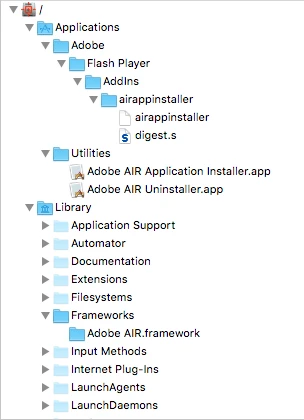

Check the permissions on the AutoPKG-created one - ran into that once, have a postinstall shell script which fixes them.
IIRC it's mostly /Library/Frameworks/AdobeAIR.framework and the app installer/uninstaller in /Applications/Utilities...

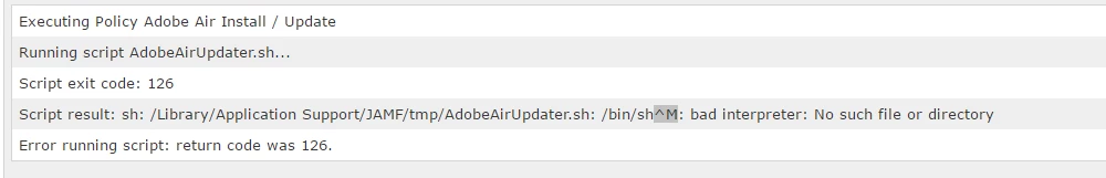

@joe.farage
Whenever we attempt to run this .sh we get this error, I'm sure where to start looking to resolve this issue.
Any assistance would be awesome. Thanks!
In your script, look for line 71. Try this line in it's place:
/Volumes/Adobe AIR/Adobe AIR Installer.app/Contents/MacOS/Adobe AIR Installer -silent -eulaAccepted

This is the error that now occurs after making the change that @millersc suggested.
How are you editing the script? looks like bad character. Could try putting that line in " " and remove the back slashes.

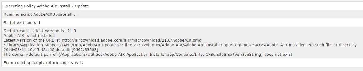

Hi, I am trying the above script and receiving the following error:
Script result: Latest Version is: 21.0
Current installed version is: 16.0
Latest version of the URL is: http://airdownload.adobe.com/air/mac/download/21.0/AdobeAIR.dmg
/Library/Application Support/JAMF/tmp/Install Adobe Air Updates v2: line 71: /Volumes/Adobe AIR/Adobe AIR Installer.app/Contents/MacOS/Adobe AIR Installer: No such file or directory
I have added the additional -eulaAccepted to the script as instructed above, but it looks like the .dmg is not mounting, if I have the Adobe Air installer mounted on the desktop it works fine?
Many thanks
If you are getting the error "No such file or directory", the cause is that script doesn't work properly as of this moment, as the AKAMAI servers are responding with "301 Moved Permanently" to the AdobeAIR.dmg file.
If you allow redirections in the curl download, then the script will work fine (your discretion if you consider this to be a security issue or not).
You can fix this by adding -L to the curl command so it'll handle relocations, so the line with the download command:
/usr/bin/curl -s -o /tmp/AdobeAIR.dmg ${url}
Will be replaced to this:
/usr/bin/curl -s -L -o /tmp/AdobeAIR.dmg ${url}
And then the script will download the AdobeAIR.dmg properly and it can perform the install.
Confirmed that including the changes noted above by @millersc and @Ongelmanratkoja gets the script functional again (included in the below):

Adobe Air dev team must have had a staffing change, since their documented workflow doesn't work.
Snapshot (cringing) shows what files are installed, confirmed working on 10.11.6, 10.10.5, and 10.9.5.
Both on install and update/re-install.
Following up with a postinstall script:
