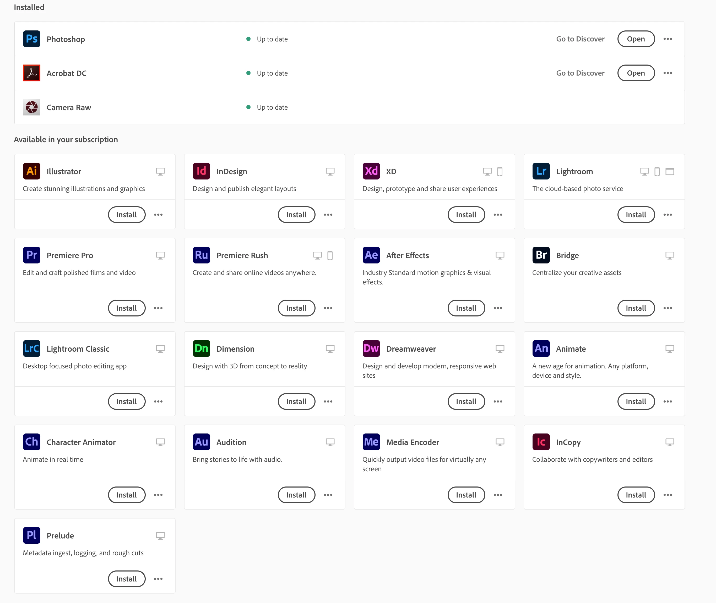

  • Jul 10, 2020 8:55 PM UTC
If it means only installing what they want, I won't mind that. Just switched to Named User Licensing leveraging our logins with federation. Working well! Our licensing only gives access to the items in the below screen shot.
