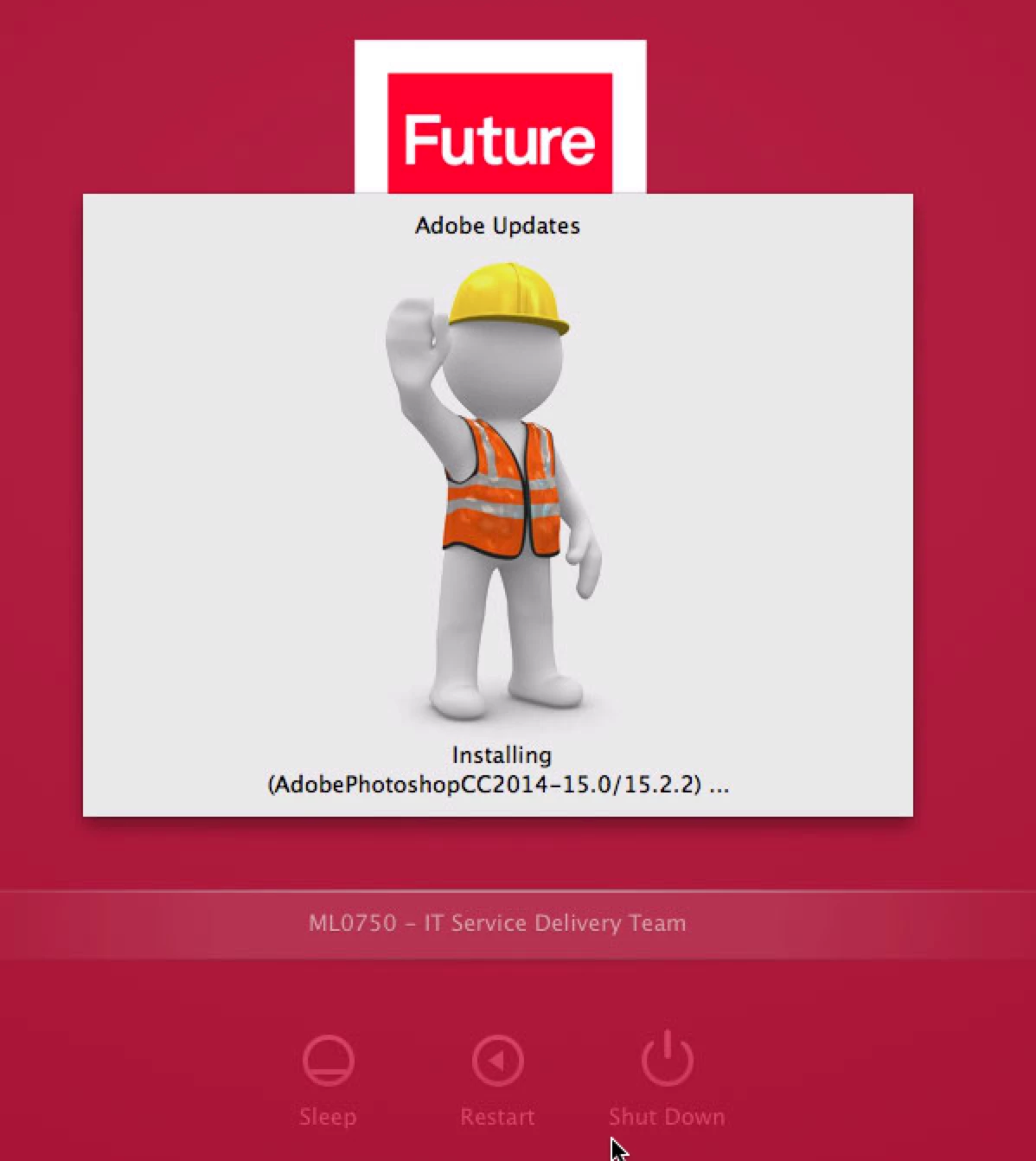

What happens if you run it as root from the command line with a verbose output. You could do this over ssh without a need to have anyone logged in.
installer -verboseR -pkg /path/to/installer.pkg -target /
In fact, here is a picture of our already deployed 2014 being updated by our internal Adobe Software Update Server using the RemoteUpdateManager as part of a script run when the loginwindow is started after a user logs out.
