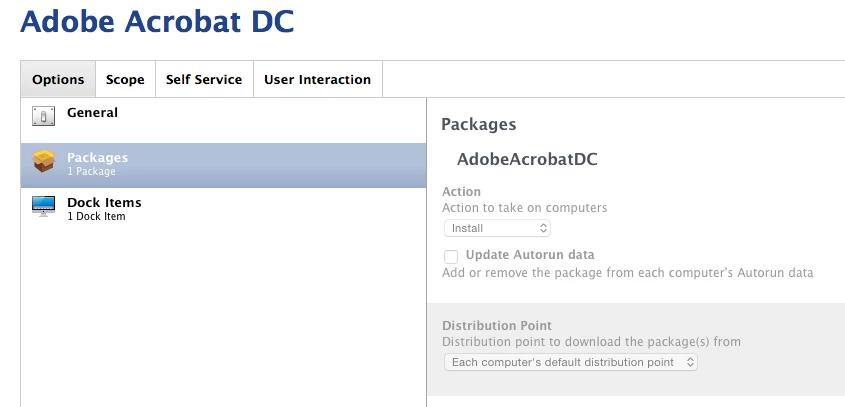

I have no problems installing Adobe Acrobat DC via Self-Service.

On a second computer I was able to install just Acrobat via Self Service and then all of the other Creative Cloud apps via Self Service without any problems. On a third computer I was able to install all of the Creative Cloud apps including Acrobat without a problem. So maybe there was something weird on the first computer.
  • June 26, 2015
UPDATE: I created a package with all CC apps except Acrobat and was able to deploy it successfully to a non-logged in computer (copied package via scp, then ssh'ed to computer and ran package via installer command). It's definitely something with the Acrobat package. More testing next week, I guess!

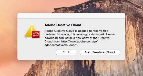

I was having the same issue. I was able to install the full suite from Self Service, but the same package failed when installing during imaging.
After reading all of the above comments, I recreated my Adobe CC 2015 package without Acrobat using CCP, and have successfully installed the full suite at imaging time. I then created a separate installer for Acrobat Pro DC and have successfully deployed both the Acrobat and CC 2015 package at imaging. Acrobat priority 10, CC 2015 priority 15.
  • June 29, 2015
I have the same issues. The complete package works when installed through the Self Service. During imaging it fails.
I just made a new package without Acrobat DC and then it installs fine during imaging. So now I do the same as @stevevalle .

@stevevalle No such love for me. I'm not using Casper Imaging (DeployStudio actually, which is calling the Casper binary with a custom trigger for my first boot policies), but Acrobat will not install when no one is logged in. The rest of the suite installs just fine.
I found some more log files (/Library/Logs/Adobe/Installs/ there's one file for each app) and cross-referenced these against installer.log. From these it's clear that the issue is that a component of Acrobat is attempting to determine the current user and is failing.
Jun 29 12:23:07 adj-102-m0l5a.local installer[11440]: PackageKit: Executing script "./postinstall" in /private/tmp/PKInstallSandbox.Yo5SKG/Scripts/com.adobe.AcroServicesUpdater.BIimfb Jun 29 12:23:08 adj-102-m0l5a.local installer[11440]: PackageKit: Executing script "./postinstall" in /private/tmp/PKInstallSandbox.Yo5SKG/Scripts/com.adobe.armdc.app.pkg.z8tQI2 Jun 29 12:23:08 adj-102-m0l5a.local installer[11440]: ./postinstall: Info: Installing updater files... Jun 29 12:23:08 adj-102-m0l5a.local installer[11440]: ./postinstall: Installing asset /Library/Application Support/Adobe/ARMDC/Application/Acrobat Update Helper.app Jun 29 12:23:08 adj-102-m0l5a.local installer[11440]: ./postinstall: Copying /tmp/com.adobe.AcrobatRefreshManager/Acrobat Update Helper.app Jun 29 12:23:08 adj-102-m0l5a.local installer[11440]: ./postinstall: Installing asset /Library/Application Support/Adobe/ARMDC/Application/AcrobatUpdaterUninstaller Jun 29 12:23:08 adj-102-m0l5a.local installer[11440]: ./postinstall: Installing asset /Library/Application Support/Adobe/ARMDC/Application/Adobe Acrobat Updater.app Jun 29 12:23:08 adj-102-m0l5a.local installer[11440]: ./postinstall: Copying /tmp/com.adobe.AcrobatRefreshManager/Adobe Acrobat Updater.app Jun 29 12:23:08 adj-102-m0l5a.local installer[11440]: ./postinstall: Installing asset /Library/Application Support/Adobe/ARMDC/Application/AcrobatUpdateHelperLib.dylib Jun 29 12:23:08 adj-102-m0l5a.local installer[11440]: ./postinstall: Info: Installing ARMDC Agent update registration file... Jun 29 12:23:08 adj-102-m0l5a.local installer[11440]: ./postinstall: Installing file /Library/Application Support/Adobe/ARMDC/Registered Products/com.adobe.ARMDCHelper.plist Jun 29 12:23:08 adj-102-m0l5a.local installer[11440]: ./postinstall: Info: Installing HelperTools... Jun 29 12:23:08 adj-102-m0l5a.local installer[11440]: ./postinstall: Installing com.adobe.ARMDC.SMJobBlessHelper Jun 29 12:23:08 adj-102-m0l5a.local installer[11440]: ./postinstall: Installing com.adobe.ARMDC.Communicator Jun 29 12:23:08 adj-102-m0l5a.local installer[11440]: ./postinstall: Info: Installing HelperTool plists... Jun 29 12:23:08 adj-102-m0l5a.local installer[11440]: ./postinstall: 2015-06-29 12:23:08.219 ARMInstallTool[11570:43090] Trying to get User name from HOME Jun 29 12:23:08 adj-102-m0l5a.local installer[11440]: ./postinstall: 2015-06-29 12:23:08.220 ARMInstallTool[11570:43090] Trying to get User name from CF APIs Jun 29 12:23:08 adj-102-m0l5a.local installer[11440]: ./postinstall: 2015-06-29 12:23:08.221 ARMInstallTool[11570:43090] Unable to get user name of current user Jun 29 12:23:08 adj-102-m0l5a.local installer[11440]: ./postinstall: Failed to create the scheduler Jun 29 12:23:08 adj-102-m0l5a.local installer[11440]: ./postinstall: ERROR: Postinstall exited with error code -1. Jun 29 12:23:08 adj-102-m0l5a.local installer[11440]: PackageKit: Install Failed: Error Domain=PKInstallErrorDomain Code=112 "An error occurred while running scripts from the package “Acrobat DC Installer.pkg”." UserInfo=0x7fca65ea0200 {NSFilePath=./postinstall, NSURL=#armagent.pkg -- file://localhost/Volumes/CreativeCloud2015_AcrobatOnly_Install/CreativeCloud2015_AcrobatOnly_Install.pkg/Contents/Resources//Setup/APRO15.0en_US/Acrobat%20DC/Acrobat%20DC%20Installer.pkg, PKInstallPackageIdentifier=com.adobe.armdc.app.pkg, NSLocalizedDescription=An error occurred while running scripts from the package “Acrobat DC Installer.pkg”.} { NSFilePath = "./postinstall"; NSLocalizedDescription = "An error occurred while running scripts from the package U201cAcrobat DC Installer.pkgU201d."; NSURL = "#armagent.pkg -- file://localhost/Volumes/CreativeCloud2015_AcrobatOnly_Install/CreativeCloud2015_AcrobatOnly_Install.pkg/Contents/Resources//Setup/APRO15.0en_US/Acrobat%20DC/Acrobat%20DC%20Installer.pkg"; PKInstallPackageIdentifier = "com.adobe.armdc.app.pkg"; } Jun 29 12:23:08 adj-102-m0l5a.local installer[11440]: install:didFailWithError:Error Domain=PKInstallErrorDomain Code=112 "An error occurred while running scripts from the package “Acrobat DC Installer.pkg”." UserInfo=0x7fca65ea0200 {NSFilePath=./postinstall, NSURL=#armagent.pkg -- file://localhost/Volumes/CreativeCloud2015_AcrobatOnly_Install/CreativeCloud2015_AcrobatOnly_Install.pkg/Contents/Resources//Setup/APRO15.0en_US/Acrobat%20DC/Acrobat%20DC%20Installer.pkg, PKInstallPackageIdentifier=com.adobe.armdc.app.pkg, NSLocalizedDescription=An error occurred while running scripts from the package “Acrobat DC Installer.pkg”.} Jun 29 12:23:09 adj-102-m0l5a.local installer[11440]: Install failed: The Installer encountered an error that caused the installation to fail. Contact the software manufacturer for assistance. Jun 29 12:23:14 adj-102-m0l5a.local installd[275]: ./preinstall: CCP Package Installer : Exit code of AdobeDeploymentManager is (79)
The component appears to be some sort of updater schedule mechanism. Updates are disabled in my CCP package (users are non-admins) so I'm not sure why this is even installing. I'm going to look for ways to disable it, or even modify the post flight script that is causing the problem.

@etippett
This is the error I receive using a serialized package of InDesign 2015.
  • July 8, 2015
@Abdiaziz Yeah, that's the same one I was getting. Are you including the Creative Cloud Desktop app in your package? I realized I misspoke earlier. I can't say for sure whether CCP 9.0.0.106 fixed it or not, as at the same time we decided to start including CCD in the package, whereas we hadn't been previously. Perhaps since CCD is in the package now that prevents the error.
