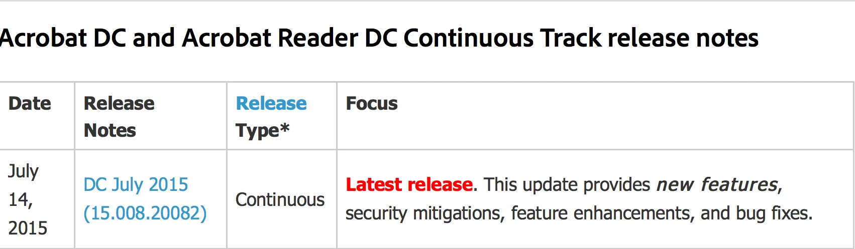

Just found this on the Adobe site
Couldn't see anything specific in the release notes at a quick glance but i'll build a new pkg and let you guys know the outcome.
@andysemak Can you share the web address where you found that?
Sure
https://helpx.adobe.com/acrobat/release-note/release-notes-acrobat-reader.html

Thanks @andysemak . Here's some other info I found:
https://www.adobe.com/devnet-docs/acrobatetk/tools/ReleaseNotes/DC/dccontinuousjuly2015.html
I did get a voicemail from the Adobe tech support rep I've been working with that a new version had been released. He didn't specifically say it would fix this issue, but I assume that's why he called. He did not provide a version number, but did say he'd send a download link, though I've not received that yet. I'll post updates as I get more info on what version is supposed to fix this.
OK, I got the installer link from my Adobe tech, but it's an incremental update, not a full installer. This won't solve the issue then, since I would still need to install the broken CCP package first, then this update. I've responded asking for more details. It is version 1500820082 that supposedly fixes the issue, however.
