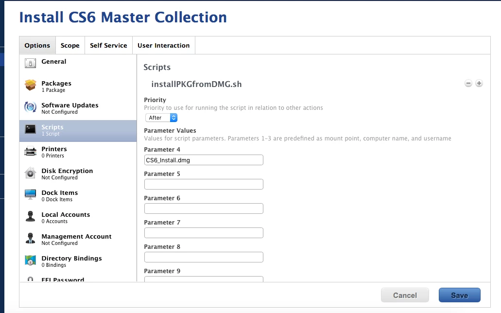

Then I tried Josh's method:
https://jamfnation.jamfsoftware.com/article.html?id=161
When I deployed it through Computer Policy, I received the following error.
Executing Policy Install CS6 Master Collection Mounting CasperDP01 to /Volumes/CasperShare... Caching package CS6_Install.dmg... Running script installPKGfromDMG.sh... Script exit code: 0 Script result: Variable "dmgName" value is set to: CS6_Install.dmg
Mounting the DMG CS6_Install.dmg...
DMG mounted successfully as volume /Volumes/Adobe on device /dev/disk1.
ls: /Volumes/Adobe: No such file or directory
Installing Package from mount path /Volumes/Adobe...
/Library/Application Support/JAMF/tmp/installPKGfromDMG.sh: line 169: /usr/sbin/jamf: No such file or directory
There was an error installing the package. Exit Code: 1
Unmounting disk /dev/disk1...
"disk1" unmounted.
"disk1" ejected.
Unmounting file server...
Any idea?

@wangl2 it looks like you may have a couple issues. One would be the volume name of your DMG as noted by @sean and the other is the path to the jamf binary. I think the location for the jamf binary was changed in version 9.8 to /usr/local/bin/jamf. If you're using 9.8 or later you'll want to fix that as well.

@mpermann @sean I read my error log and corrected two things.
Since I am on Casper 9.82, I changed /usr/sbin/jamf to /usr/local/bin/jamf in the script.
In terms of the path of the package, I am a bit confused here. The "CS6_Install.dmg" was uploaded through Casper Admin and it is saved to my file repository on the DP. The actually location of the file is on the second Data partition of the DP (/Volumes/Data/CasperShare/Packages/). I did not specify the path in the script. The only thing I did in the script is specify the name "CS6_Install.dmg" in Parameter 4 in policy. Is there anymore to configure in the policy?
I am testing the installation again with this updated script before I change anything else. I will keep you guys updated.
Thanks.
