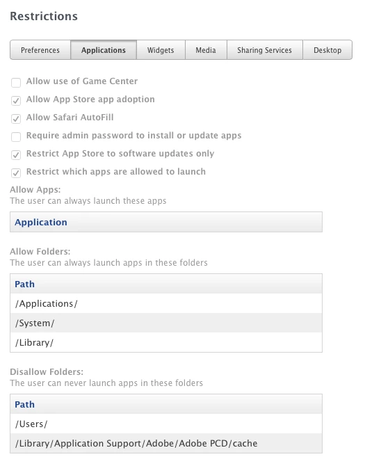

  • June 25, 2015
@brushj We have done it successfully I believe. I went through and made a whole new security policy with a Configuration Profile for this year swapping over from MCX. Inside this profile I have in the Application Restrictions specific folders that are black/whitelisted. I put this Adobe PCD folder inside the blacklist and it has not affected the opening of the Adobe apps at all thankfully, but still works in blocking the apps that the students copied to this folder. The thing with this is that it specifically blocks apps from running in there and what Adobe does in that folder is just create a new cache file when the Adobe apps run, so it doesn't affect it.

  • June 29, 2015
@GSquared Thanks for the confirmation, just wanted to let you know that we tested this out in our environment and have been successful as well. Thanks for the idea.
