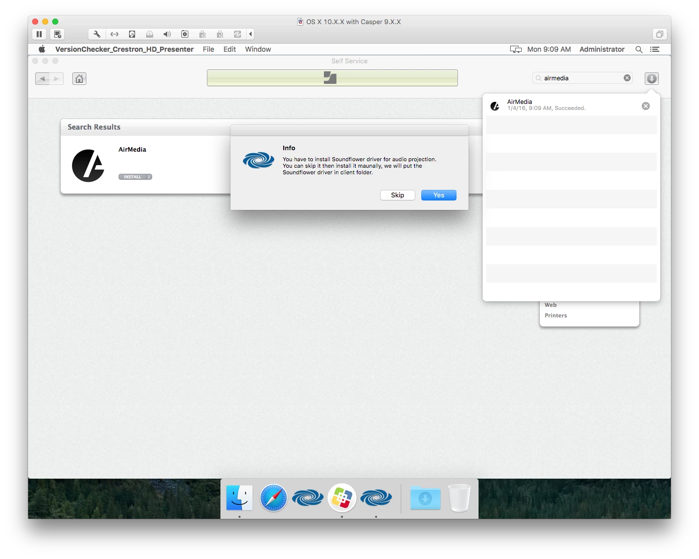

Hey there, all! I'm trying to install AirMedia to client machines in my organization via a push policy and also extend availability in Self Service. The problem that I am running into is that at the end of the AirMedia installation wizard, a window titled "VersionChecker_Crestron_HD_Presenter" appears asking the user to install Soundflower as it's needed for audio functionality.
I thought that this was strange and just added the Soundflower installer into the policy and set the priority such that the Soundflower installer runs before AirMedia. No such luck here either as the the same window prompts. I grabbed the PKG for AudioMedia directly from Crestron (link below).
I guess I could run Composer and extract the "VersionChecker_Crestron_HD_Presenter" window but would prefer to leave the installer intact and add a script to suppress the window. How does this sound? Is there another approach that I should consider?

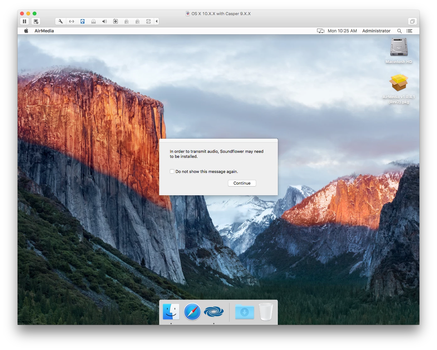

Very helpful suggestions so far, all--thanks! But man oh man, is this installer persistent. I get the below message regardless of whether Soundflower is included in the installer or not. I even took a snapshot of the package AFTER I hit "do not show this message again."
Any ideas on getting rid of this little fella attached below?
mm2270
  • January 4, 2016
That may be coming from that "VersionChecker" app that gets installed. Did you also exclude that from your final package? Or, is that actually a needed item for the software to function?

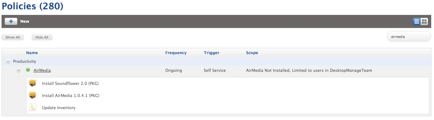

sepiemoini
Forum|alt.badge.img+21
  • Employee
  • January 4, 2016
@mm2270 I think I've got it! I removed all instances of Soundflower from the package contents from Composer as suggested. In the policy itself, I added Soundflower as a separate package altogether and altered the priority so it's installed before the AirMedia package. I am no longer getting any errors or prompts so I think, aside from IP issue that appears to be an internal issue, I'm all set--thanks!

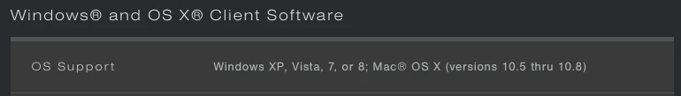

C
  • January 4, 2016
I'm pretty sure that the AirMedia client for Mac specifically states its only supported up to OS X 10.8 because SoundFlower only works reliably up to OS X Mountain Lion 10.8.5. I'm pretty sure the SoundFlower project has been abandoned for a few years now.
As for packaging, I used Composer to just grab the contents from the Applications folder and everything worked as expected on all OS X installs from 10.6.8 -> 10.11.2. Of course, without SoundFlower working audio is not supported.
