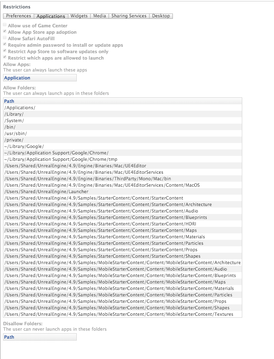

Now, when the students access textures and such, it needs access to a whole lot of other folders, the user is given a "You do not have permission to launch X" error
You can see in my screen shot, I'm starting to add way to much stuff, when really, I'm just trying to grant full read access from
/Users/Shared/UnrealEngine/
- (Currently still need to specify specific exact folders, they dont inherit permissions from this level)
Attached is a screen shot of the policy. Nothing else is scoped out to the device.

I've tried the wildcard, unfortunately this doesn't push down permissions to the subfolders.
I've also tried packaging the program with full read access, but the above profile is still blocking the subfolders.

No other profiles scoped to the machine. Do you guys think it may be the 'Restrict which apps are allowed to launch' tickbox?
I actually dont know the chmod777 would work, just an assumption. I'll test.
Thanks for the ongoing support
EDIT
I now ran a config profile with an unticked Restrict which apps are allowed to launch tickbox. It now works, but now the students could potentially run any app, game etc. So I'm not sure this is a complete solution. Does anyone have anything further?
