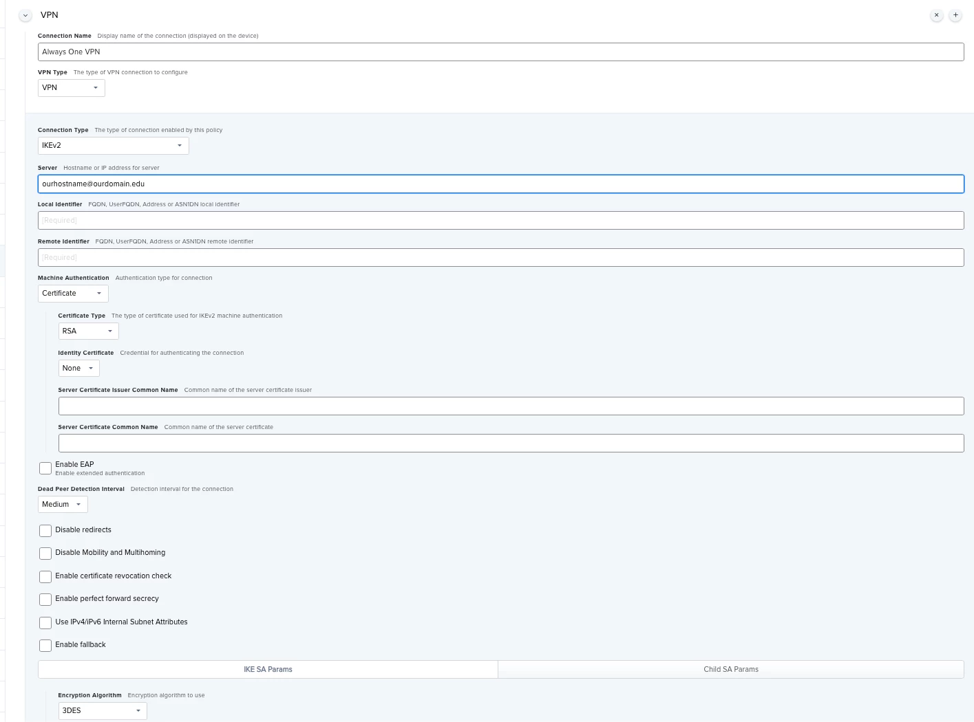

Can anyone that has implemented "Always On VPN" with their Macs via Jamf share their steps?

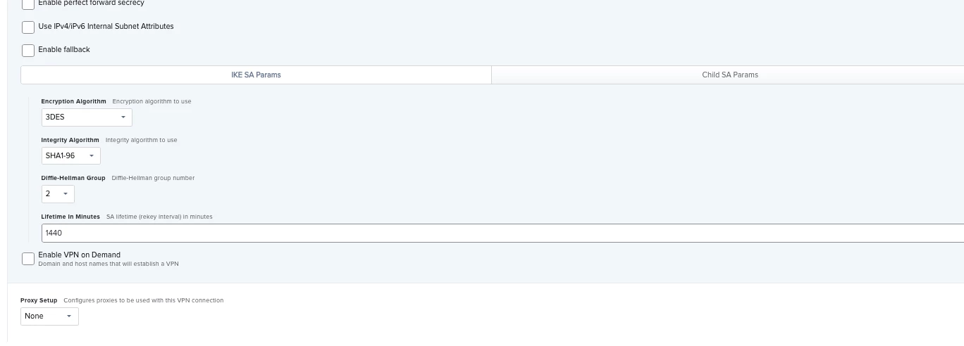

Here is where I am at so far. Our networking department gave me a couple of certificates that need to be installed on the client machines that will have the Always On VPN service enabled.
I think that I need to enable my Jamf Pro server as a SCEP proxy so I can get the two certificates in on the Macs. OR, can I just put the certificates in my VPN profile, like we do with our Network profiles for SSIDs?
Next, I believe I need to create a VPN configuration profile. Here is screenshot(s) of where I am with that so far:

Hi @dtmille2 - the screen you showed above seems to be for iOS.  I thought you were trying to do AoVPN for Mac's?
I too am trying to figure out how to do this for Mac's - did you get anywhere?

Thanks @dtmille2  - Jamf Support pointed out my mistake - had to change to User profile in General section.
I'll check out AnyConnect but we will be doing machine auth using a Certificate
