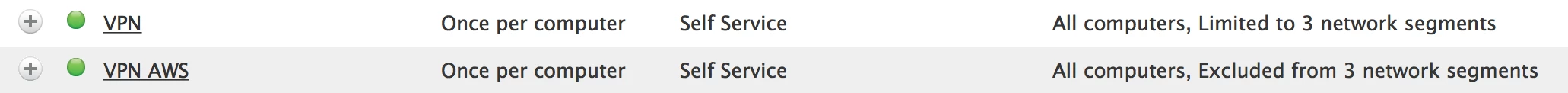

  • October 9, 2015
We have duplicate policies for this, one excludes the internal networks and is hosted by AWS, the other is limited to the internal networks and is hosted by our internal JDS's. So depending on our users location they get the correct policy.. down side is it only really works with smart groups as otherwise when they come back into the building they would receive the opposite policy so we have to update the inventory and thus the smart group's as apart of the policy.
