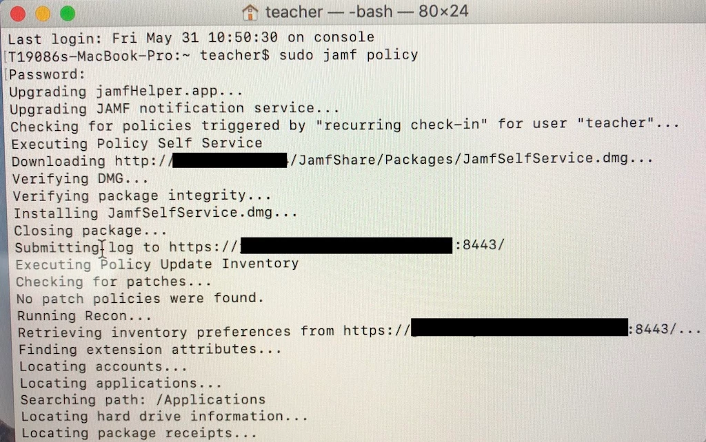

I just wanted to add something I'm seeing with machines with this issue. When we do an initial "jamf policy" to get Self Service to come down (because Enrollment Complete trigger is still super unreliable, sigh), I get the "upgrading jamfHelper.app" and "upgrading JAMF Notification Service" as seen in this screenshot. I find the messages odd as these are fresh out of the box Macs. Just thought I'd share these in case JAMF is watching this thread. Sadly I am dealing with too many dumpster files right now to open a case, and it seems quite a few already have anyway.
