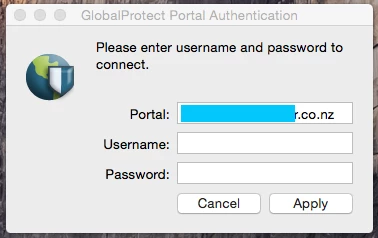

We've deployed GlobalProtect for our users however, when a user logs in a GlobalProtect window pops up asking for the user's VPN login credentials. This window pops up at every login until a user makes a successful connection to the VPN.
I can't see a setting in the UI or plist to modify this behaviour to prevent the pop up window. Has anyone got a solution to this?

@adhuston This is the pop up window we see on each login until the user makes a single successful connection to the VPN.
1 user logs in 2 The agent appears in the menu bar
3 the pop up window appears
Do you not see this window in your deployment?

Hi paulnz,
Yep, we do see that authentication window when someone logs in. Unfortunate side affect of the application. We just try to make sure that the portal address is filled in so that end users only need to put in their credentials. We tried adding a login task to kill the service, but it keeps respawning and keeps popping up the authentication window. So much for a on demand service I guess. I would like it so much better if you could launch it interactively.

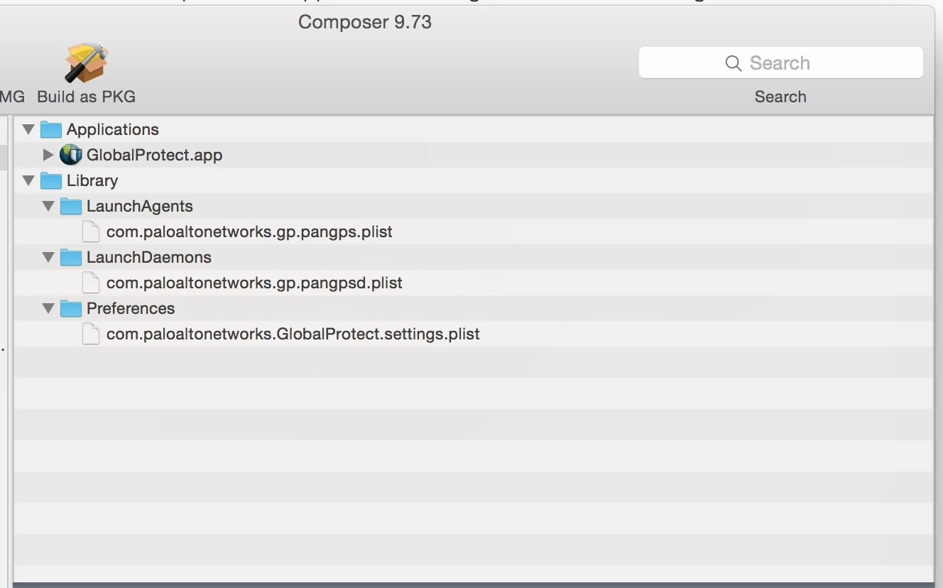

  • Sep 2, 2015 11:15 PM UTC
We're moving to GP VPN here as well and have felt the pain of the app auto-launching since we started using this.
After getting fed up with it and realizing we're not using on-demand, I went ahead and fixed it my own way:
Did a usual Composer pre-capture and then did the following...
-Installed the latest version of GP available on our PANs (2.3.0-28)
-Dropped a known good/working (see @dfuhriman's post) /Library/Preferences/com.paloaltonetworks.GlobalProtect.settings.plist into the correct place and set permissions/ownership - this places our VPN address in the app automatically.
Captured the changes and then...
-Deleted the LaunchAgent called "com.paloaltonetworks.gp.pangpa.plist" from /Library/LaunchAgents - this is what starting the app.
Here's a look at the result in Composer:
Packaged the App and dumped into Admin...
Since doing this, I've tested and deployed it, and watched the app not auto-start anymore.
