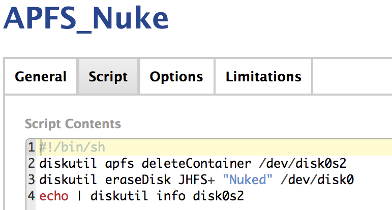

We are trying to create a script that converts an APFS to HFS+ during a Netboot. The script we are using is below
We can netboot and run the command from terminal however if we try and run the command from a script in JSS it does nothing.
Any help would be great.

Just adding more info
The following doesn't work either
diskutil apfs deleteContainer /dev/disk1s2 NewNuked
In Casper Imaging logs, all the scripts we have in the configuration have the following message (with the respective script names)
Downloading APFS_Nuke...
Could not download APFS_Nuke to the cache.
The script is set to run Before everything else in the config, and not on reboot
