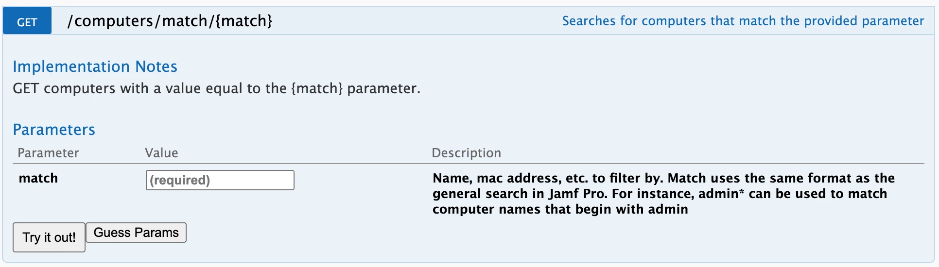

Hi @BND10706 I've done something somewhat similar.
I think the /JSSResource/mobiledevices/match/ is what you are looking for.
#Applescript prompt to request asset tag
assetTag=$( osascript<<APPLESCRIPT
tell application "System Events" to text returned of (display dialog "Please enter asset tag below:" default answer "" buttons {"OK"} default button 1)
APPLESCRIPT)
#Searches based on what was inputed into the AppleScript prompt
data=$(curl website.com/JSSResource/mobiledevices/match/$assetTag*
-H "Accept: text/xml"
-X GET
-u username:Saltedpassword
-s )
#Filter the $data result to the the id and perform the rest of your script...
