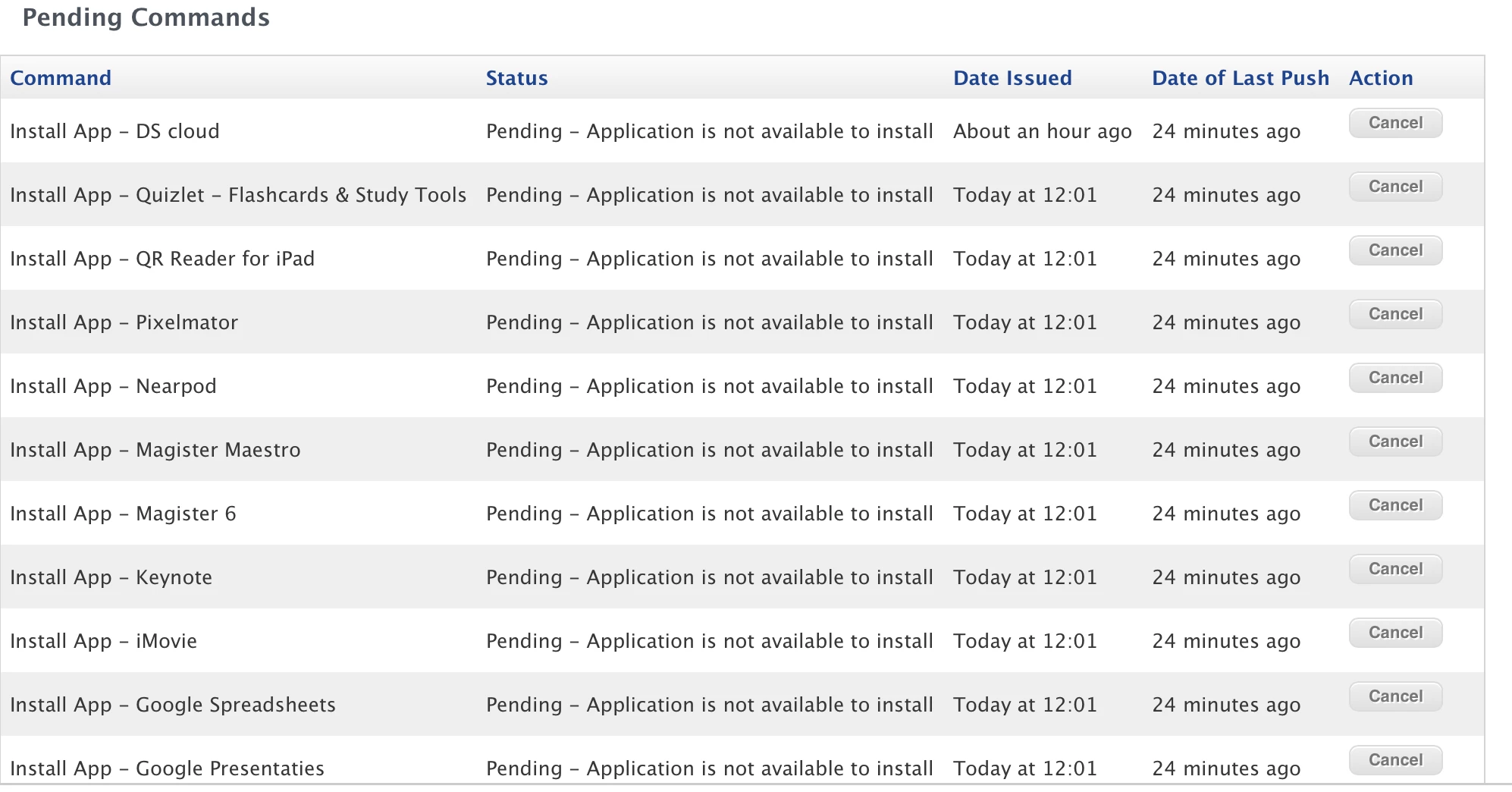

We upgraded our environment to 9.9 since then our apps are not being distributed to our managed iPads.
We keep getting this from the management tab - "Pending - Application is not available to install"
When troubleshooting this problem I could trace it down to the "Limitations" option we have for deployment. When we distribute a App to the All Managed iPads it will install on the iPad, but when we combine it with the Limitations Tab thats connected to our Active Directory via LDAP and combine it with a user group from there the app won't install and gives the error. This is how we always distributed our apps before 9.9.
Anyone know how I can fix this to use my groups again, since not every group in my organization needs the same apps. Manually assignments is no option.

I am having the same issue today in version 9.9
After configuring the JSS. I purchased vpp content. The content gets populated in the JSS. When I try to push the apps to some devices I get the same error. App distribution VPP "Pending - Application is not available to install"

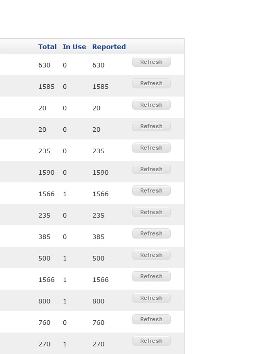

We are having the same issue. In our environment we are not using AppleID's, so we have also found that apps that have already been downloaded and installed have become unusable. The users are then being confronted with a message to login with an AppleID. Also, under Global Management -> VPP Accounts, the licenses are populated with our purchase as mentioned above, but the "In Use" column reads "0" instead of what it had previous to the update.
Can anyone confirm the same symptoms?

Some apps show no licenses are in use but other have licenses in use and we still get this error.
  • April 5, 2016
Thank you for the quick reply @martin , but I am a little confused on your answer. Are you saying that all the devices need to be updated to 9.3 or 9.3.1? If so, we can make that happen, but it still does not explain why our JAMF server is not recognizing the utilization of the license / allowing new downloads even on updated devices.
If you could please clarify what steps need to be taken I would greatly appreciate it.
Thank you again.
Just for me to clarify, this is what we are seeing in the JAMF VPP Section.
