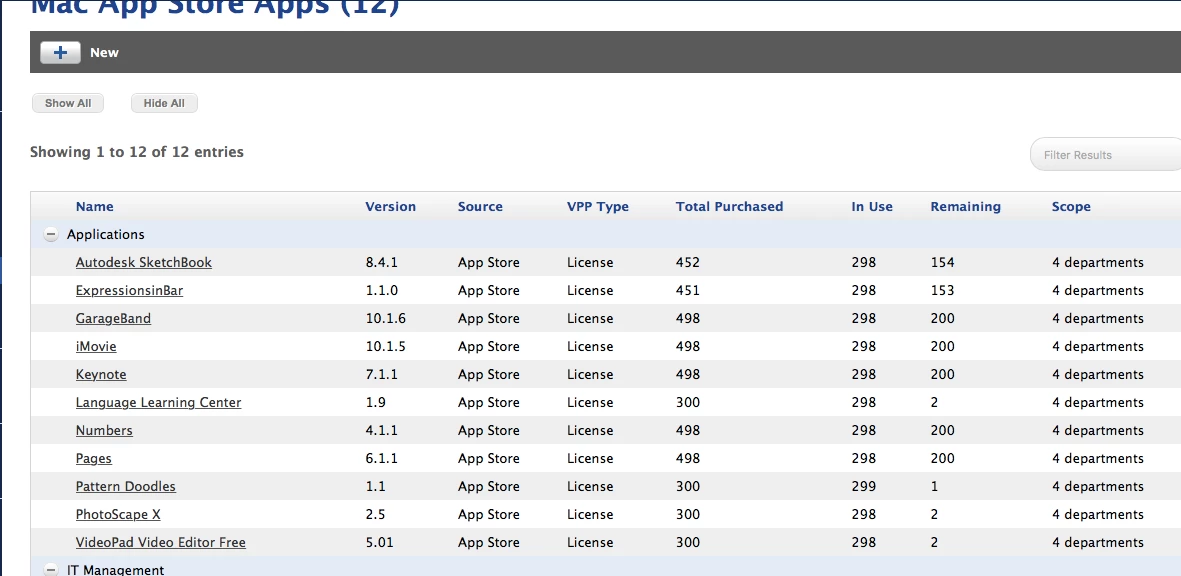

I am probably asking the most foolish question here, but I'm not sure what I am doing wrong! I see there is an app update for pages, keynote, numbers. I have a caching server, that I'm in hopes I set up correctly, and I have the programs updated on that. I can see in my JSS that the newest versions are sitting there and scoped out correctly. However, it should push an automatic update to the 300+ devices I have but it is not. My users do not have apple id's, it is all very managed. How can I push the updated versions to my users? Or am I completely missing something?? Thank you for your help in advance, I greatly appreciate it :)
@nhubbard What happens if you use the Force Update button in the Mac App Store Apps entry for one of those apps? (you have to be in Edit mode for the Mac App Store App record before that button will be visible)
@nhubbard according to this you may be experiencing a known product issue. You might want to reach out to Jamf Support to see what they say. They apparently have a hotfix for 9.98 that fixes the issue.
Thank you both! I will try the force update but will also reach out to Jamf. I couldn't figure it out, as it had worked in the past but I think you might be right with the 9.98 hotfix, update, etc. because I believe now that you mentioned it that's when I started having issues.
