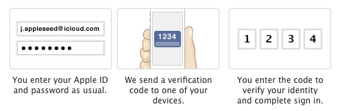

@CasperSally are you following the instructions at the below site to setup 2 Step on your AppleID account?
Frequently asked questions about two-step verification for Apple ID
Once you've enabled 2 Step on your AppleID, when logging into GSX it will send you a 4 digit code on your phone to enter into the screen.
