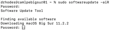

Hi,
Also trying this out.
Anyone else getting this on M1 Airs? (see image)
Also, possible to not post the password in the script result? Would love to not see the Users passwords.

That said , It is unclear to me why 'softwareupdate' should work like this. When I run the command manually it is just stuck with no output (other then downloading and installing updates)
