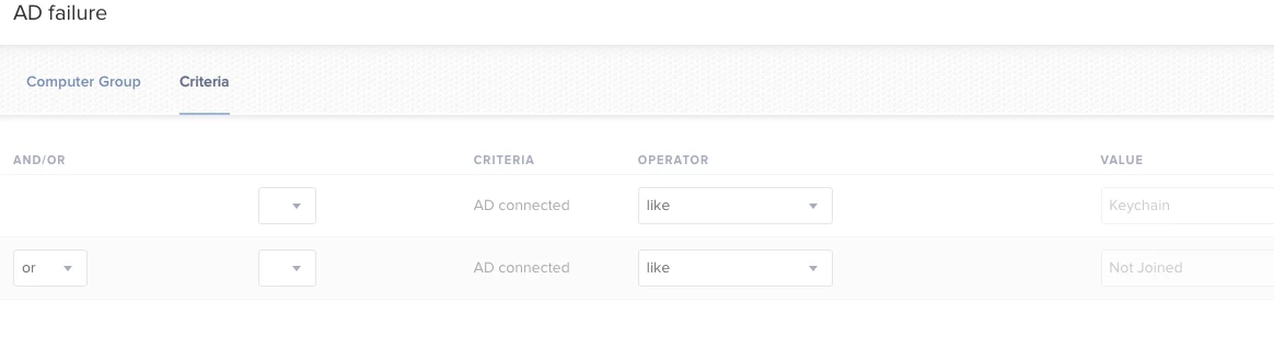

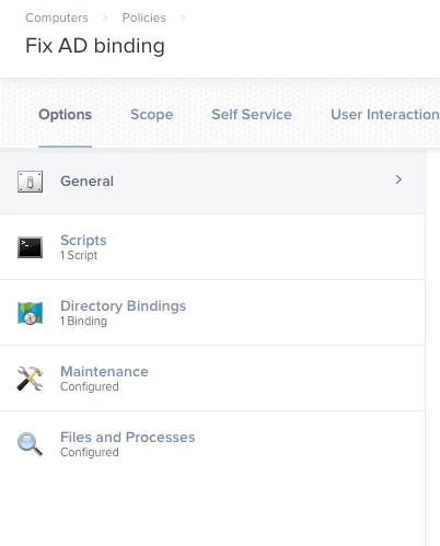

Build a Policy that runs at recurring check in and is scoped to a smart group with the following criteria:
The Script is the one above.
Directory Binding is whatever you have configured for Directory Binding.
Maintenance is to run Inventory -Ignore Files and Processes in this screenshot. I run an extra command for our internal purposes that has no bearing on the fix.
