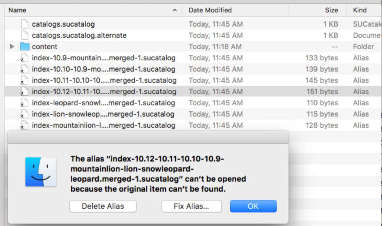

@StoneMagnet , no I get the error:
Not Found
The requested URL /index.sucatalog was not found on this server.
However, I don't know if it makes a difference but if I go to, http://servername.ourdomain.com:8088/catalogs.sucatalog I get this:
CatalogsList http://servername.ourdomain.com:8088/content/catalogs/others/index-10.12-10.11-10.10-10.9-mountainlion-lion-snowleopard-leopard.merged-1.sucatalog http://servername.ourdomain.com:8088/content/catalogs/others/index-10.11-10.10-10.9-mountainlion-lion-snowleopard-leopard.merged-1.sucatalog http://servername.ourdomain.com:8088/content/catalogs/others/index-10.10-10.9-mountainlion-lion-snowleopard-leopard.merged-1.sucatalog http://servername.ourdomain.com:8088/content/catalogs/others/index-10.9-mountainlion-lion-snowleopard-leopard.merged-1.sucatalog http://servername.ourdomain.com:8088/content/catalogs/others/index-mountainlion-lion-snowleopard-leopard.merged-1.sucatalog http://servername.ourdomain.com:8088/content/catalogs/others/index-lion-snowleopard-leopard.merged-1.sucatalog http://servername.ourdomain.com:8088/content/catalogs/others/index-leopard-snowleopard.merged-1.sucatalog PrimaryCatalog http://servername.ourdomain.com:8088/content/catalogs/others/index-10.12-10.11-10.10-10.9-mountainlion-lion-snowleopard-leopard.merged-1.sucatalog

@rharrington The index.sucatalog URL should return the catalog appropriate for the OS version loading it. Would it be possible for you to set up another system with Server.app running SUS to see if it exhibits the same problem? I run a NetSUS rather than Server.app for my SUS, and it's working normally, so I'm wondering if there's an issue in what Apple is downloading to Server.app SUSes.

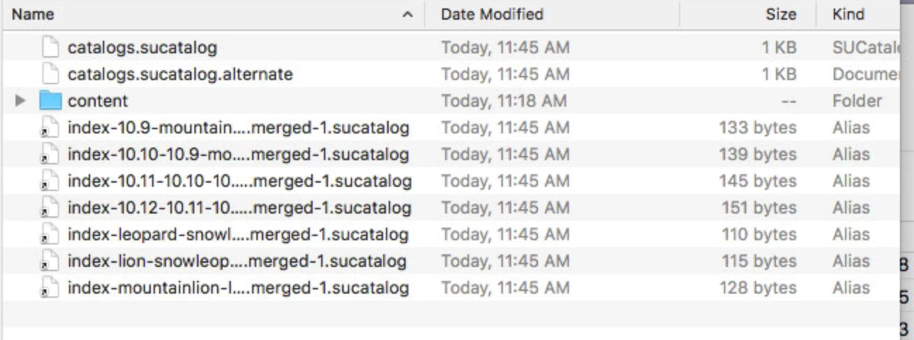

Just made a new OS install and fresh Server install and I see the same thing. What is odd, and I'm wondering if this is the problem, is that the index files are all created as aliases and they appear to be broken. @rharrington are you seeing the same thing?
  • July 18, 2017
@gabriel_martinez Same thing here:
Spent some time with Apple on the phone. We got it working by deleting the broken fixing the broken aliases in the html folder. The index-10.12-10.11-10.10-10.9-mountainlion-lion-snowleopard-leopard.merged-1.sucatalog file should be an alias of /Library/Server/Software Update/Data/html/content/catalogs/others/index-10.12-10.11-10.10-10.9-mountainlion-lion-snowleopard-leopard.merged-1.sucatalog.composite.
We then had to point the clients to the new url of "http://servername.domain.com:8088/index-10.12-10.11-10.10-10.9-mountainlion-lion-snowleopard-leopard.merged-1 2.sucatalog" and it worked.
Hope that helps.

  • July 19, 2017
@gabriel_martinez Hmmm, that did not work for me, I still received the "Can't load data from the Apple Software Update server." error. Also, after a reboot, the Alias changes back to the original one with the broken link.
