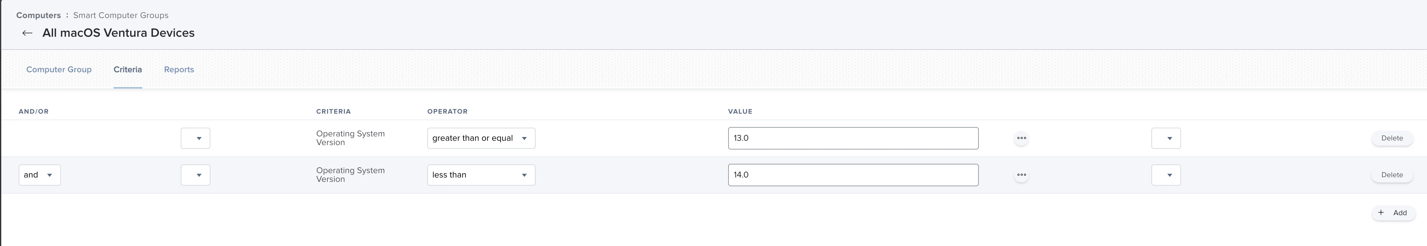

I have a simple smart group setup that separates Monterey and Ventura devices

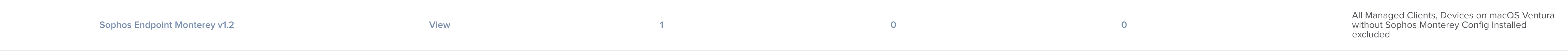

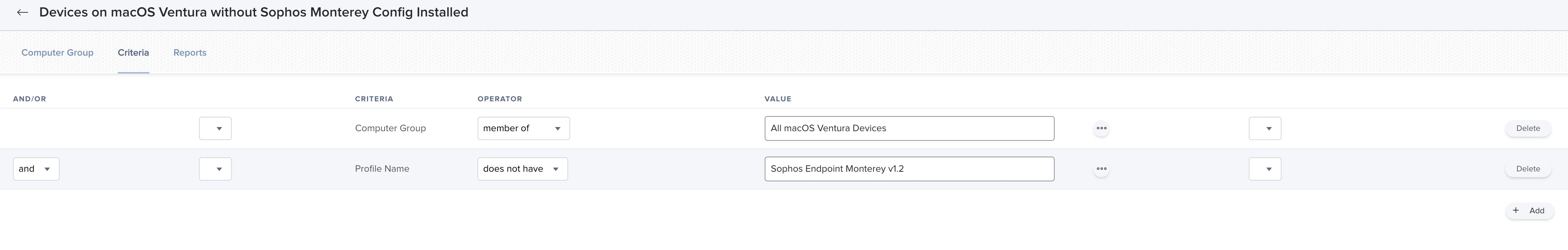

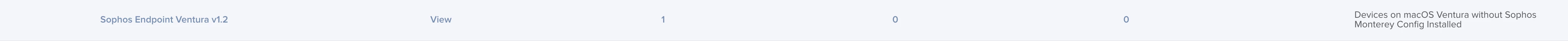

Managed to get this working applying logic from a different angle.
- I created a scope looking for devices that are Ventura but do not have the Sophos Monterey profile already installed.
- The scope for the Sophos Monterey config, I applied to all devices but excluding the scope I create in the above.
- and the scope for Sophos Ventura config, I applied the first scope I mentioned here.
The logic here is that if a device is upgrading from Monterey to Ventura it will still have the Sophos Monterey config installed so therefore the Sophos Ventura config should not be applied and the Sophos Monterey config should stay.
But if a device has Ventura installed but doesn't already have the Sophos Monterey config, then install Sophos Ventura config.
I will be testing this by downgrading to macOS Monterey and then upgrading to macOS Ventura to see if the Sophos Monterey config stays persistent across upgrades. I've already tested fresh installs of Ventura, the correct configuration profile is applied which is Sophos Ventura config as it should.

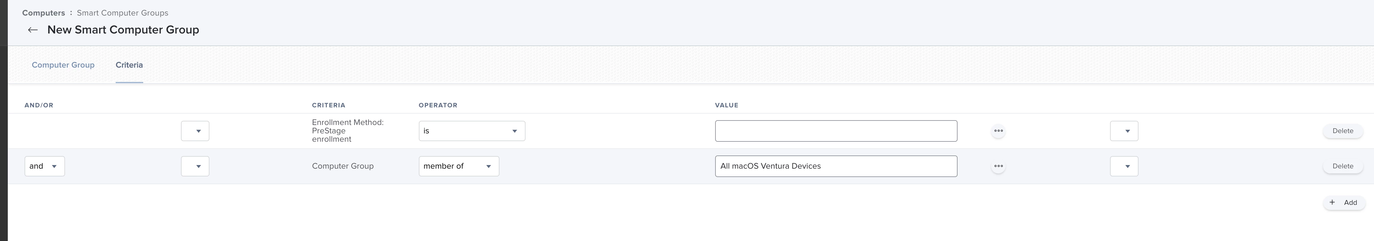

@_aDiedericks How about a smart group with criteria for macOS Ventura and Last Enrollment less than 1 days.
Thanks.

_aDiedericks
  • November 20, 2022
Thanks.
@karthikeyan_mac Just checking the logic of this criteria. If a device passes 2 days after enrolment would it then not fall out of this scope therefore losing the configuration assigned based on that scope?
_aDiedericks
  • November 20, 2022
What if the criteria specified was to look for "Enrolment method - Prestaged" and "macOS Ventura devices".
This would work based on the assumption that Prestaging only takes place during device setup i.e fresh install/reset of OS.
[UPDATE]
I've tested this upgrading from macOS Monterey to Ventura. Sophos Monterey profile is still persistent across upgrades.
