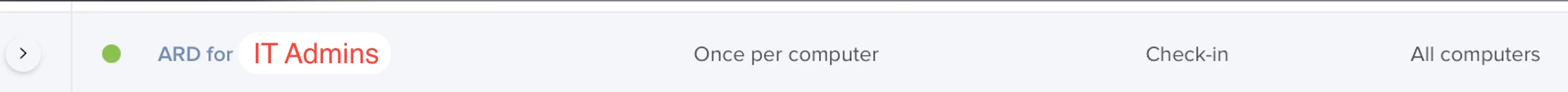

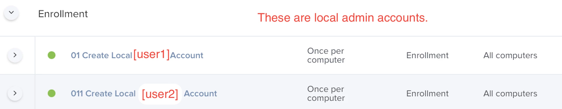

To review, here's my current workflow...
1st - a policy to create local admin accounts during my pre-stage enrollment
2nd - my ARD script
Script: Special thanks to "RossMadness."  Source Link: https://www.reddit.com/r/macsysadmin/comments/f2recc/apple_remote_desktop_and_jamf_pro/fhec8aj/
#enables screen share for specifiedusers then restarts agent
/System/Library/CoreServices/RemoteManagement/ARDAgent.app/Contents/Resources/kickstart -activate -configure -allowAccessFor -specifiedUsers -restart -agent
#specifies user then sets permissions for specified user then restarts agent
/System/Library/CoreServices/RemoteManagement/ARDAgent.app/Contents/Resources/kickstart -configure -users [user1],[user2] -access -on -privs -all -clientopts -setmenuextra -menuextra no -restart -agent
3rd - workaround, as mentioned above as needed:
In Jamf Pro, I went into a computer's Management tab and clicked Disable Remote Desktop button, refresh my screen, then do it again, a few times (which I thought was quirky) until I get the Enable Remote Desktop button.  Once I got that, I was able to ARD into the workstation as normal.

2nd - my ARD script
I figured out a simple way to enable Remote Management using a script and a custom trigger that seems to work now.
Create a script like this:
#Turn on Remote Desktop Sharing, allow access for all users, and enable the menu extra:
//System/Library/CoreServices/RemoteManagement/ARDAgent.app/Contents/Resources/kickstart -activate -configure -allowAccessFor -allUsers -privs -all -clientopts -setmenuextra -menuextra yesSystem/Library/CoreServices/RemoteManagement/ARDAgent.app/Contents/Resources/kickstart -activate -configure -allowAccessFor -specifiedUsers
... attach it to a policy, use a custom trigger, run that in Terminal or set it to run itself after enrollment. I'm testing it now, seems to work.
Step #3 seems like the only other way to Enable Remote Desktop for now as well as messing with the API.
