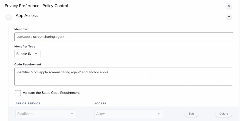

Thanks for the screenshot.  I had missed the PPPC in these posts.  Maybe that's what I'm missing.  I never had to use it before.  I'll give it a shot.

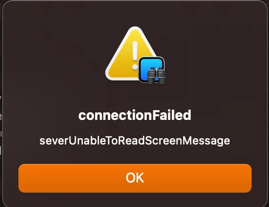

In my fleet... Not a single computer on 12.4 is working. I get that strange error every time I try to screen share. M1 or Intel, laptop or iMac...makes no difference. If I go to an earlier OS, no problem. The upgrade (?) to 12.4 is breaking every computer.

I went back and test, I believe only the PPPC profile was required for ARD. I couldn't find all the docs but from what I understand;
