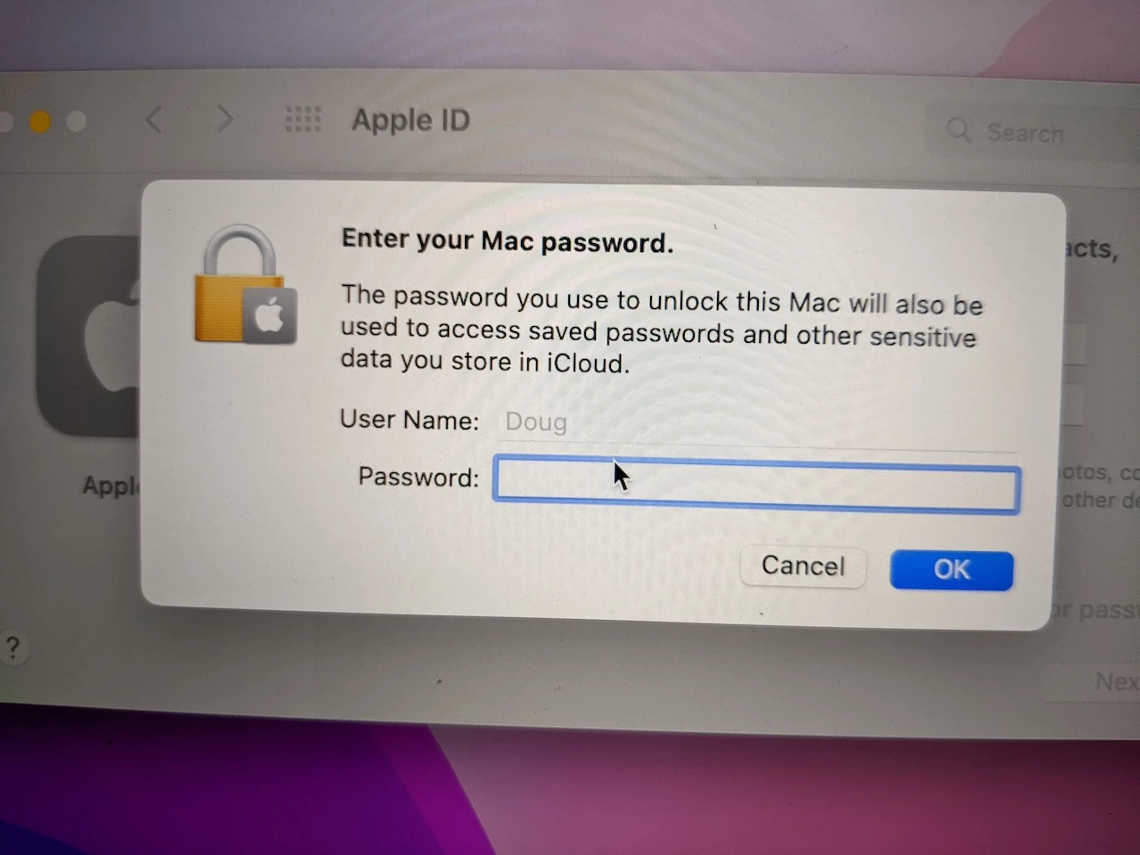

I turn on Activation lock and find my mac.  It asks me "Enter your Mac password".  So, I enter my account password.  It works and I'm n ow activation locked with find my mac.

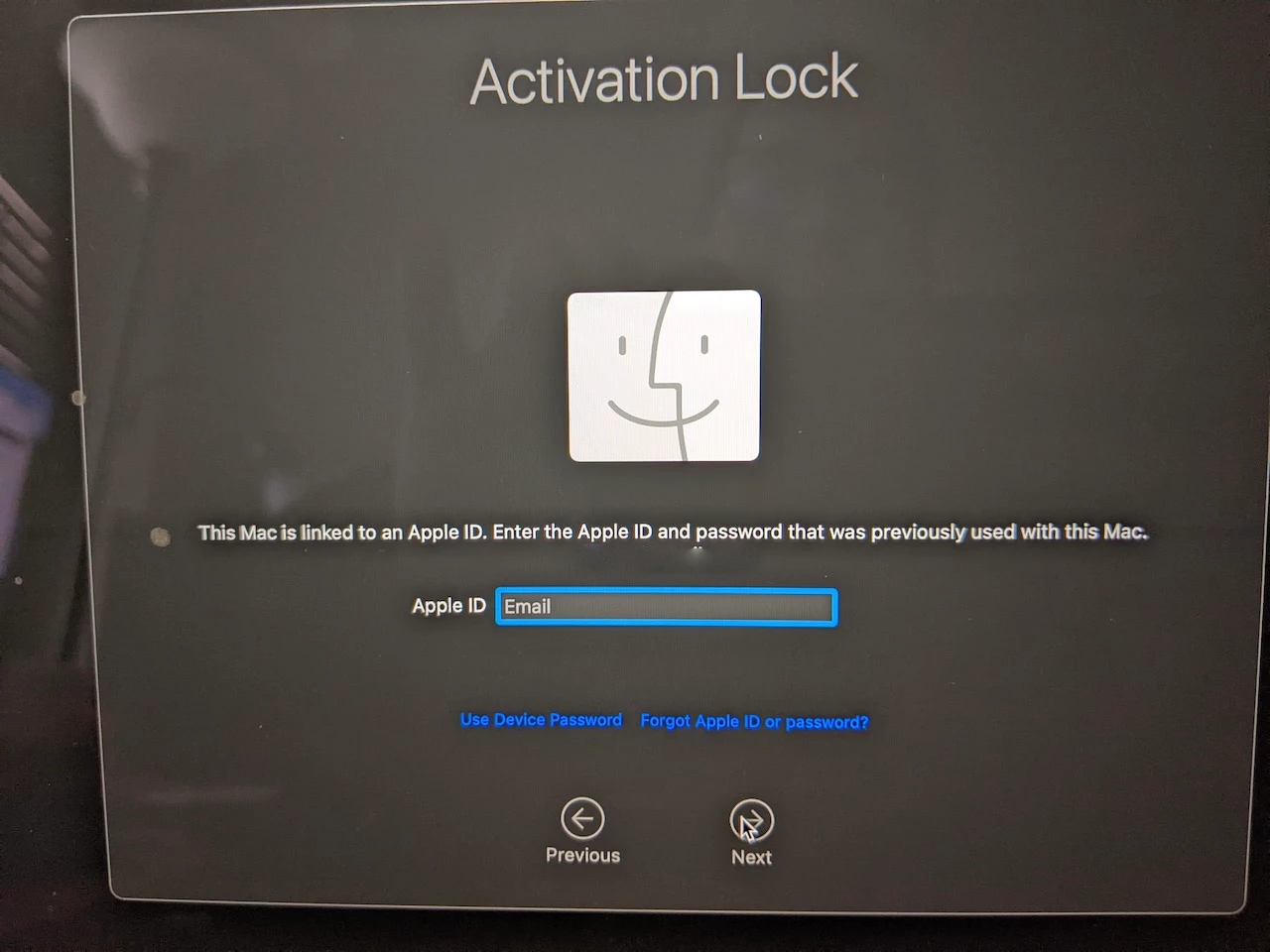

Before the computer is activated, it finds my icloud information and tells me my icloud email address with the astericks (which I've removed from the attached screenshot).   It then wants me to enter my email Apple ID and password.
But in this case, I'm testing that hey, I don't know this information.  Say the Mac has been handed back to the department and the person who turned this activation lock isn't available.
So, I click Use Device Password.

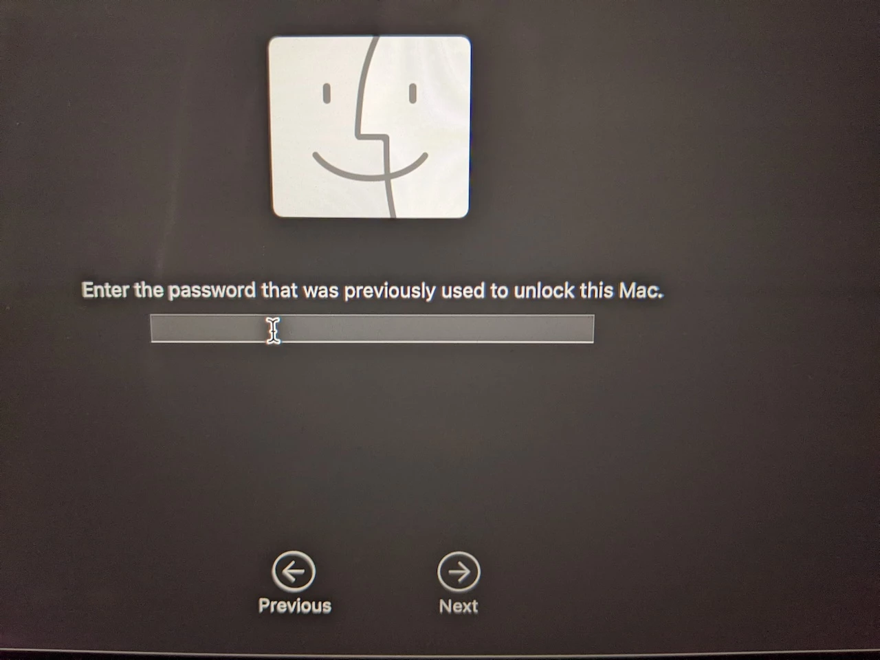

From there, I'm told to Enter the Password that was previously used to unlock this Mac.
The only password it will take will be the initial password I entered earlier when setting it up back when it initially wanted my account password.   It won't take any other administrative accounts on the computer.  And yes they have secure tokens and all that.  It's a one to one correlation to Enter the password that was previously used to unlock this mac is exactly the account used when setting up the icloud.
What if we don't know that?

On an iPad, I can just enter the activation lock code right in the password section.  My experience, this works fine on iPads.   On a mac, it want's that email address first and won't show a password field until you actually enter something in that block.
It's been my experience the JAMF Activation Lock code cannot be used in any manual way to unlock ARM based Monterey macs.
